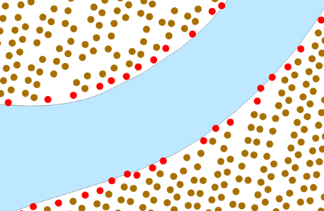

Some lidar ground points may be nearly coincident with water polygon boundaries. This can result in undesirable, sharp discontinuities at the land or water interface. To alleviate this, buffer the water polygons a short distance (for example, 0.3 meters) and use the buffered polygons to reclassify ground points to class 20, which is ignored ground by LAS classification standards. Excluding them while interpolating a raster DEM will result in a smoother transition from ground to water.
To reclassify the ground point close to the shoreline, filter the points to ground, and use the Set LAS Class Codes Using Features geoprocessing tool to reclassify the ground points to ignored ground, class 20.
Reclassified ground points
Ground points close to the shoreline are reclassified as ignored ground (displayed in red) and should be excluded when interpolating to a raster DEM when the shoreline is included as breakline data in the process.
