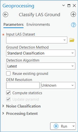

While the Classify LAS Ground tool produces good results most of the time with the default parameters, you can use the various parameters to maximize quality and minimize error. The table below describes the parameters.
Classify LAS Ground tool dialog box
Ground Detection Method
This parameter includes four options. Three of these are typically used: Standard Classification, Conservative Classification, and Aggressive Classification. These correlate with the amount of surface roughness and discontinuities that are accepted as ground. The Conservative option allows the least amount of roughness, while the Aggressive option allows the most. It is recommended that you use either Conservative or Standard, and reserve Aggressive for rugged terrain typically found in mountainous areas. Conservative is less likely to include nonground features but may miss valid ground in more rugged areas. Standard represents a good balance between the Conservative and Aggressive options when you have mixed terrain. The Conservative option is good for DEM generation because it reduces the chance of misclassifying low objects as ground. The Standard option is good for balancing omission error and commission error. The fourth detection method, Recover Ridges, is used as a post process to improve, or repair, ridges on rugged terrain that didn’t get classified correctly during the initial ground classification. It’s discussed in more detail in the Fix problem areas section below.
Detection Algorithm
This parameter includes two options: Latest and First Generation. The default is Latest. This option uses the newest generation classifier and is recommended. The First Generation option can be used, for example, to replicate or match results obtained using earlier software. In some cases, the First Generation option may have a more desirable result, but this is not typical.

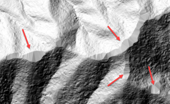

One of the most common technique is to derive a hillshade raster from a DEM that was created from the ground classified points, and have someone visually review the hillshade for anomalies. The purpose of this is to look for unnatural-looking landforms. These include unusual peaks and pits, but what is more likely are missing, or truncated, ridges in rugged terrain.
Truncated ridges

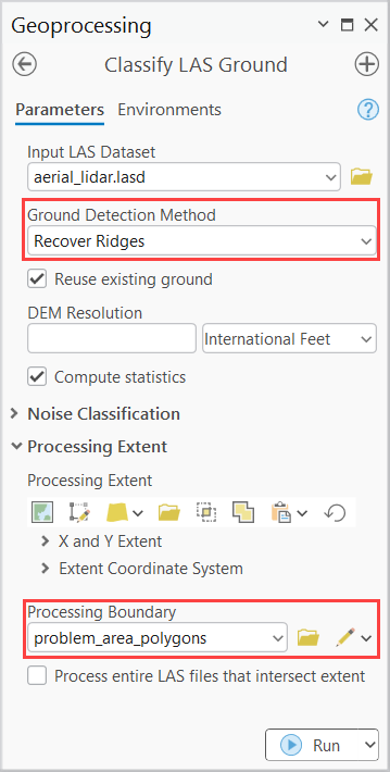

Sharp ridges can be lost in rugged terrain when the classification method is set to Conservative or Standard. While you can use the Aggressive method to avoid this, its use is not recommended unless the entire area is rugged. In the more common scenario of mixed terrain, it's better to use either the Conservative or Standard methods to obtain quality results in the less rugged areas. The trade-off is the classifier can be too restrictive in rugged areas. It identifies sharp changes in slope as unlikely to be ground, and can miss ridgelines, especially in heavily forested areas that have fewer ground hits.
To overcome problem ridges, a derived hillshade is first made from the initial ground classified points. It's used to identify problem locations. The operator digitizes polygons around problem areas. The polygons don't need to be precise. The ground classifier is then rerun, using the Recover Ridges ground detection method. When this method is selected, the Reuse existing ground parameter will be turned on and you’ll need to supply the problem area polygons as the processing extent. The polygon selection is honored, so you can pick specific areas to process and iterate over.
Red boxes highlight the relevant sections of the tool for rerunning with a more aggressive setting.
This will run a ridge-specific classification just for those problem areas while leaving the other areas alone. Another review should be made for each problem area after this rerunning of the classifier.

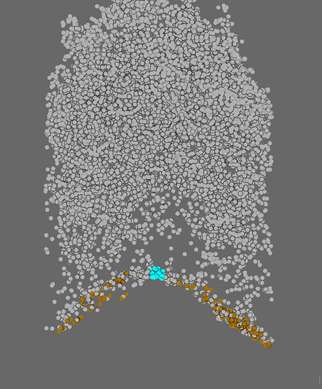

Profile view for problem area
The orientation of the profile view has been rotated so the camera is at one end of the ridge looking along it. This makes it easier to see the crown of the ridge and select the ground points.

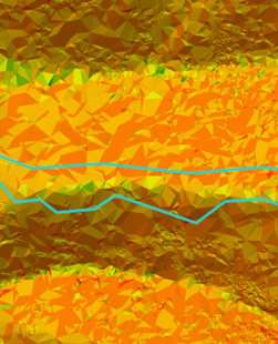

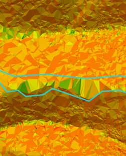

A ridge before repair A ridge after repair
The 2D map views are based on the LAS dataset drawn as a triangulated surface symbolized by a combination of slope and hillshade.
Note:
The more pronounced green in the problem area is evident before the repair. Green represents lower slope and is indicative of what happens when the top of a ridge hasn't been captured properly.

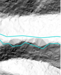

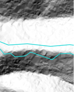

Ridge line Ridge line
The images above are similar to the previous example except for the use of hillshade alone, without being colored by slope. Visual review of hillshades is a commonly used approach to identify problems with ground classification.
