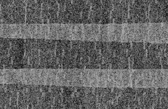

The point density variance in overlapping and nonoverlapping areas is shown. There are three flight paths of data flown in an east/west orientation with two strips of overlap area.

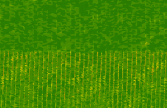

Slope surface with overlap areas
A full-resolution surface, symbolized by slope, illustrates more noise in the overlap area in the lower half of the image.

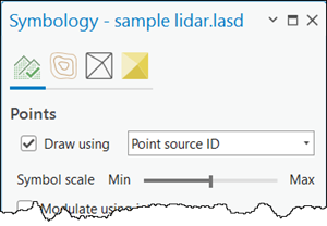

To display the points symbolized by the source ID, complete the steps below.
  1. Add the LAS dataset layer to a 2D map or 3D local scene.
  2. Open the Symbology pane for the LAS dataset layer.
  3. On the Points tab, next to the checked Draw using check box, choose Point source ID from the drop-down list.
    Symbology pane for a LAS dataset layer
    The upper portion of the Symbology pane for a LAS dataset is shown with points selected to be displayed by a point source ID.

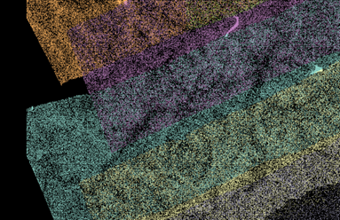

When the point source ID is set to the flight path number, you would expect the points to display in the same color for each swath, with swaths generally oriented parallel to one another with at least some degree of overlap between them.
Points symbolized by point source ID
The points symbolized by the point source ID are shown.

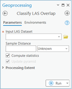

Classify LAS Overlap tool dialog box
The Sample Distance parameter represents the size of bins used to partition the points. Bins are 2D squares, and the sample distance is the length of the side of the bin.

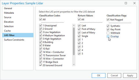

The sample distance you provide should be at least several times the nominal point spacing. It can be even greater, considering its purpose is to determine which flight path’s data is to be used for a given area. Up to several meters is reasonable. Once overlap points are classified, they can be excluded from display and subsequent analysis by filtering them out. Right-click the LAS dataset layer in the Contents pane and choose Properties. On the LAS Filter tab, under Classification Flags, uncheck Overlap.
LAS dataset Layer Properties dialog box
Point filter settings for turning on and off overlap points are available from the LAS dataset properties. The image above is for LAS version 1.4 files in which the overlap class flag is used instead of the overlap class code.
