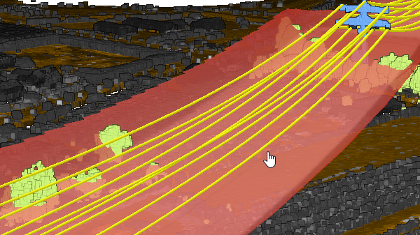

Generates a raster surface modeling the clearance zone around 3D line features.
Illustration
Generate Clearance Surface tool illustration
Usage
  • A clearance zone represents the theoretical height of an area around a particular feature that is to remain clear of intrusions from other features. In the context of electric transmission lines, this zone can represent the area of maximum height that vegetation can reach to minimize the risk of fire or other hazards; any vegetation that is higher than the clearance zone will need to be trimmed. In the context of streets and sidewalks, the clearance zone can represent the lowest height that vegetation can encroach over the paths of vehicles, cyclists, and pedestrians to not compromise safety. For shipping channels, the clearance zone can represent the navigable path that must be cleared of any sedimentary deposits.
  • The clearance surface can be compared to a height surface modeling real-world measurements to determine where clearance zones are violated. You can use the Cut Fill tool to evaluate the two surfaces to determine the surface area and volume of each contiguous clearance zone violation. The height surface created from real-world measurements should reflect the directional bias of the clearance zone. For example, if the clearance zone defines the maximum height of a potential source of intrusion, as is the case with vegetation encroachment of powerlines or sedimentary deposits along shipping channels, the height surface created from real-world measurements should have a bias for maximum height values of trees and sedimentary depositions. Likewise, if the clearance zone defines the minimum height of a potential source of intrusion, such as vegetation around sidewalks and roadways, the height surface created from real-world measurements should have a bias for minimum height values. The height surface of real-world measurements in LAS data can be created using the LAS Dataset To Raster tool, and the Point Cloud To Raster tool can be used for I3S point clouds.
  • Use the Extract Power Lines From Point Cloud tool with the option to eliminate the effect of wind when generating power lines that will be used as input for modeling clearance zones. The position of points capturing power lines are usually distorted by the effect of wind, which can cause significant deviations in the position of the power line. Eliminating for the effect of wind results in the creation of power lines reflecting the normal path of the conductor cable.
  • If the clearance zone requires the incorporation of multiple raster surfaces modeling different types of clearance requirements, use the Mosaic To New Raster tool with the appropriate merge operator for the type of clearance being modeled.
