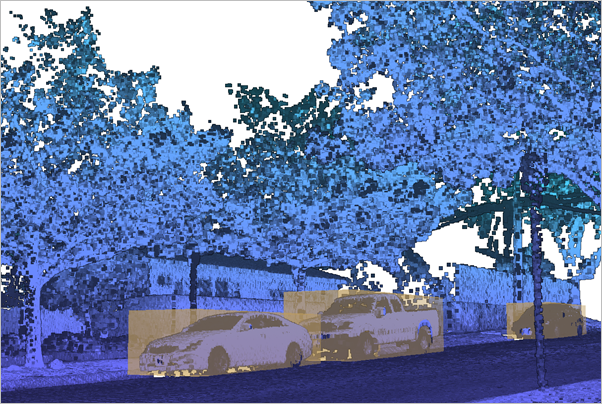

  • The point cloud object detection training data is defined by a directory with a .pcotd extension that contains two subdirectories: one containing data used for training the model and the other containing data used for validating the model throughout the training process. An input point cloud must always be specified along with separate multipatch features representing the bounding boxes of objects for training and validation. A boundary polygon can be provided to limit the data that is exported for training. The validation data can be defined by the following:
    • Provide a validation point cloud in addition to the input point cloud. This dataset must reference a different set of points than the input point cloud. A boundary can also be specified to clip the validation point cloud.
    • Provide only an input point cloud with a training and validation boundary. This will result in both the training and validation data being sourced from the same input point cloud, so there is no need to specify a dataset for the Validation Point Cloud parameter. Avoid overlaps between the two boundary polygon datasets so you don't use the same point cloud data for training and validation.
  • Contain each object type that is present in the point cloud within a multipatch bounding box. Unidentified objects in the training or validation data will result in the model being unable to effectively learn how to identify the object. If the point cloud contains unidentified objects, use boundary features to limit the exported training datasets to places where objects were properly contained in a bounding box.
  • The points representing the objects do not need to be classified to be used in the training dataset for object detection. This simplifies the task of labeling the objects to only creating bounding boxes as multipatch features. Bounding boxes can be generated through interactive 3D editing of a multipatch feature class. However, if objects are represented by classified point clouds, bounding boxes for those points can be created through the Extract Objects From Point Cloud tool.
