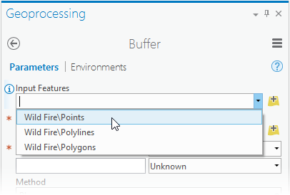

Select KML layer from list of layers
If you have added a KML layer to your map, most geoprocessing tools that accept feature layers can also use the KML layer as input. To use the KML layer, select the name of the KML layer from the drop-down list of layers for the input parameter.
Select a KML layer from the drop-down list of layers for the input parameter
You will notice that the KML layer name is appended with one or more feature types. For example, your KML layer Wild Fire will display as Wild Fire\Points in the list of layers. Since a KML layer can contain multiple geometry types and geoprocessing tools only work with a class of homogeneous geometries, you must specify which features in the KML layer to process. Feature types include the following:
