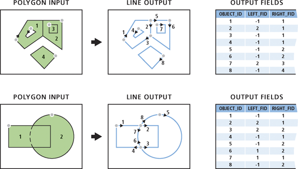

  • If the Identify and store polygon neighboring information parameter is checked, the polygon neighboring relationship will be analyzed. The boundaries are converted to lines, taking into account crossing or shared segments. The following fields will be added to the output:
    • LEFT_FID—The feature ID of the input polygon to the left of the output line.
    • RIGHT_FID—The feature ID of the input polygon to the right of the output line.
    The attributes of the input features will not be maintained in the output.
    The following scenarios describe the process and output in more detail:
    • In a polygon geometry, the outer boundary is always stored in a clockwise direction. If the polygon has a hole, the hole (or inner) boundary is always stored in a counterclockwise direction. Therefore, for a polygon with no neighbors to the left side (outside) of its outer boundary and the left side (inside) of the hole boundary, the resulting lines will have a value of -1 for the LEFT_FID field value and the polygon feature ID as the RIGHT_FID field value.
    • When a polygon contains another polygon, one output line in the clockwise direction will be generated representing the shared boundary, and its LEFT_FID field value will be the outer polygon feature ID and the RIGHT_FID field value will be the inner polygon feature ID.
    • When two polygons share a portion of their boundaries, one output line will be generated representing the shared segment. The line direction will be arbitrary, and the LEFT_FID and RIGHT_FID field values will be the left or right polygon feature ID accordingly.
    • When a polygon overlaps another polygon, two output lines will be generated representing each crossing boundary twice. The first line will represent the outer boundary of one of the overlapping polygons, and its LEFT_FID field value will be the feature ID of the polygon it crosses, and its RIGHT_FID field value will be its own polygon feature ID. The second line will be in the opposite direction, splitting the other polygon, and its LEFT_FID and RIGHT_FID field values will be the same as the other polygon feature ID.
    • Input multipart features are not maintained; the output lines will all be single part.
