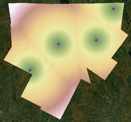

Determining how far away one thing is from another is the basic element of calculating distance. It is the straight-line or Euclidean distance between two points. For additional information, see Calculate straight-line distance.
Map of straight line distance calculated from four points
Straight-line distance is calculated from each cell to the closest electrical substation (purple points). The distance is measured in linear units.

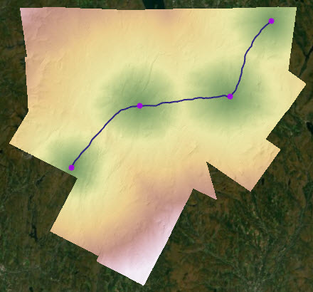

Use the Optimal Region Connections tool to connect a series of locations or regions with the shortest or least-cost network of paths. With this tool, it doesn't matter which regions are connected to which. You want them to be connected in the shortest or least-cost way possible. To do this, you specify the locations or regions to connect and, optionally, a cost surface. In the resulting network of paths, you can reach any location from any other location, although you may need to pass through a location to reach a distant location.
Four points connected with the paths of least cost
The four electrical substations (purple points) are connected by powerlines that take the least cost paths between the stations (blue lines).
