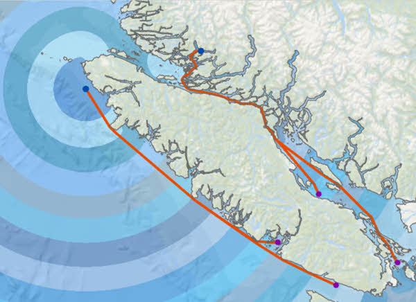

The following image shows the output (blue bands) from the new Distance Accumulation tool with an input barrier, along with output (orange lines) from the new Optimal Path As Line tool:
Image showing the distortion free distance accumulation raster with the optimal paths as lines
The image shows the distortion free distance accumulation raster with the optimal paths as lines.

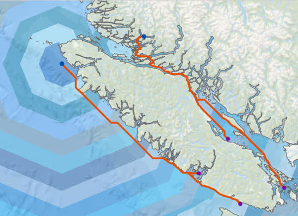

The image below shows the output (blue bands) from the legacy Cost Distance tool using a constant input with barriers encoded as NoData, along with output (orange lines) from the legacy Cost Path As Polyline tool. As you can see, the smooth shapes generated by the new tools (above) are more representative of real-world conditions than those generated by the earlier tools (below).
Image showing the legacy cost distance surface with the legacy least cost paths
The image shows the legacy cost distance surface with the legacy least cost paths.
