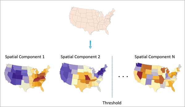

Decomposes a feature class and neighborhood into a set of spatial components. The components represent potential spatial patterns among the features, such as clusters or trends.
The components are returned as fields of the output feature class and represent variables of the input features and neighborhood that have the strongest possible spatial clustering (spatial autocorrelation). The components are called Moran eigenvectors, and each component represents a different spatial pattern that are each independent of each other.
