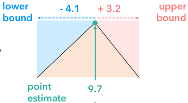

Triangular
A triangular distribution is commonly used when the original value represents a likely estimate of the true value. The Triangular option of the Simulation Method parameter is particularly useful with asymmetric distributions in which the values are more likely to cluster around the estimated value but with an asymmetric spread. A triangular distribution is constructed and used to simulate data for each feature based on the minimum data value, the feature’s original value, and the maximum data value. The Uncertainty Type parameter value determines the minimum and maximum data values of the triangular distribution.
A chart of a triangular distribution
The shape of the triangular probability distribution ensures that values close to the original value are more likely to be generated than values in the extremes of the distribution.
Note:
Unlike the normal distribution, the shape does not need to be symmetrical. For example, the lower and upper bound may differ.

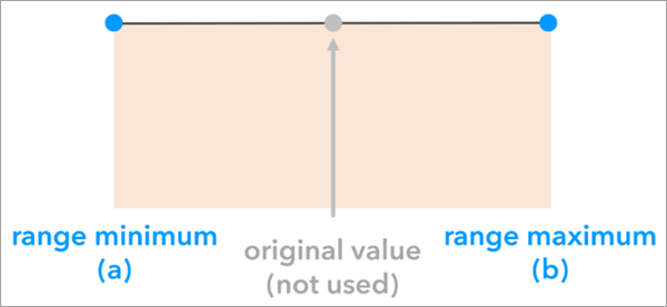

Uniform
The Uniform option of the Simulation Method parameter is used when the original value at each location is a poor estimate of the true value, and the only available information about attribute uncertainty is the range of possible values. This option uses a uniform probability distribution with two parameters: the minimum in the range set by the uncertainty type, and the maximum in the range set by the uncertainty type. Unlike normal and triangular distributions, the uniform distribution does not use the original value in the probability distribution parameters; each value between the minimum and maximum is equally likely to be generated in the simulations.
A chart of a uniform distribution

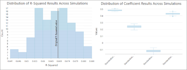

Generalized Linear Regression tool
When assessing the uncertainty of a Generalized Linear Regression analysis, the main results of the Generalized Linear Regression tool are charts that display the distribution of regression diagnostics across the simulated runs, such as R-squared and explanatory variable coefficients. The tool provides a group layer containing a copy of the original analysis result, a table summarizing the results from repeated runs of the original tool, and three charts displaying the distribution of R-squared, Jarque-Bera statistical significance, and standardized explanatory variable coefficients.
Example charts that the tool produces when assessing the uncertainty of a generalized linear regression analysis

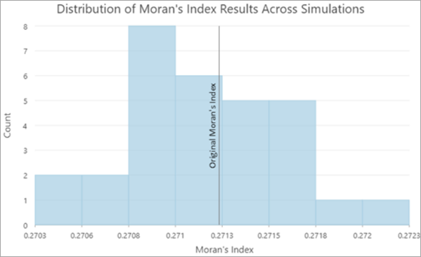

Spatial Autocorrelation (Global Moran's I) tool
For the Spatial Autocorrelation (Global Moran’s I) tool results, the goal of the tool is to help you understand how certain the original assessment of global spatial autocorrelation would be under attribute uncertainty. The tool provides a group layer with a copy of the original analysis results, a table summarizing the results of repeated runs of the tool, and charts displaying the distribution of Moran’s index values and their z-scores.
An example chart that displays the distribution of Moran's index values
Generally, most of the Moran's index values and their z-scores will be smaller than the original values because adding random uncorrelated noise to data values tends to reduce the spatial autocorrelation of the data.

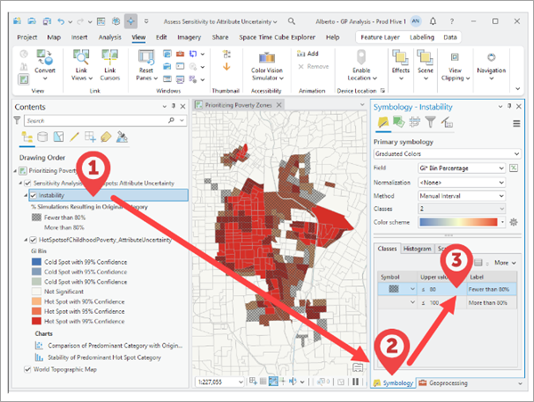

Alter the stability threshold in the output
For Hot Spot Analysis (Getis-Ord Gi*), Optimized Hot Spot Analysis, Cluster and Outlier Analysis (Anselin Local Moran’s I), and Optimized Outlier Analysis tool results, the instability layer applies a default stability threshold of 80 percent. This means that for a feature to be considered stable, the feature must result in the same category as the original analysis in more than 80 percent of simulations. Increasing this threshold will designate a higher number of features as unstable, and decreasing this threshold will designate fewer features as unstable.
The threshold that defines stability can be configured using the layer symbology settings. To change the threshold, you must first find and select the instability layer in the output group layer. Second open the Symbology pane, and third double-click the Upper value cell for the 80 percent class and edit the threshold value.
Changing the stability threshold

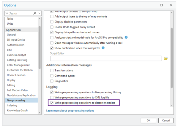

Geoprocessing operations metadata
To find the analysis tool, input features, and additional parameters used in the analysis, the tool reads the metadata from the Analysis Result Features parameter value. Consequently, the analysis that produced the analysis result features must be configured to write to metadata.
This setting is activated by default. To confirm this setting, open the Options dialog box, click the Geoprocessing tab, and in the Logging section, verify that the Write geoprocessing operations to dataset metadata option is checked.
The Write geoprocessing operations to dataset metadata option checked on the Geoprocessing tab on the Options dialog box
