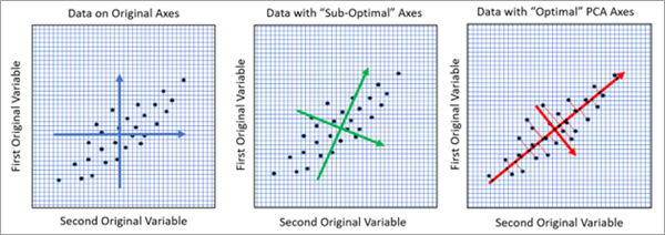

For two analysis fields, you can visualize PCA geometrically as rotating axes in the data space where the rotation maximizes the ratio of the variability of the new axes, as shown in the following image:
PCA in two dimensions
In the image on the left, each point is a record of the input table that is plotted in two dimensions with the values of the two analysis fields on the x- and y-ax es. The length of the blue axes represents the variance of each of the two variables. The lengths of the two blue arrows are approximately equal, indicating the two variables have approximately equal variance. In the middle image, the axes have been rotated to better represent the linear relationship between the variables. One of the green axes is slightly longer than the other, indicating more variance in that direction. However, this rotation is not optimal. The image on the right shows the optimal rotation found by PCA that lines up with the linear relationship between the variables. This rotation produces a red axis with the highest amount of variance. The larger red axis corresponds to the first principal component and is the best one-dimensional representation of the two-dimensional data. In all three images, the total variance of the original variables is the same, but the image on the right has assigned the largest possible amount of the variance to the first component, leaving the least possible amount of variance remaining for the second component.

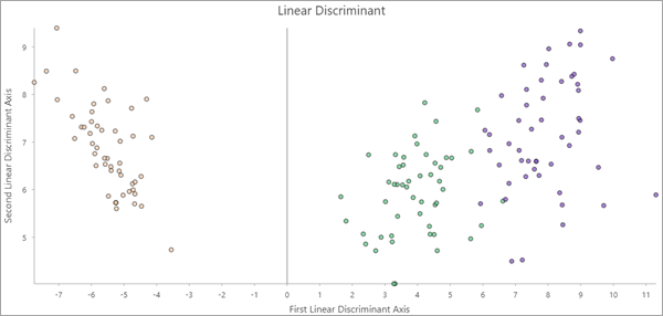

If at least two components are created, the output features include a Linear Discriminant scatterplot. The values of the first and second components are plotted on the axes, and the points are colored by their category. If the first two components maintain enough information to differentiate the categories, the points in the plot may cluster by category.
Linear Discriminant plot

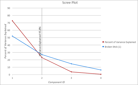

The output eigenvalues table comes with a customized line chart, called a scree plot, to show the percent of variance maintained by each component. In the scree plot below, the x-axis shows each sequential component, and the red line shows the percent variance explained by each component. The red line decreases, indicating that each new component maintains a smaller amount of variance than the previous component. The vertical black line above component 2 on the x-axis indicates that the tool used two components, and they maintained 95.8 percent of the total variance of the original variables. The blue line shows the results of the Broken Stick method used to estimate the optimal number of components. The optimal number of components often corresponds to where the red and blue lines cross, indicating agreement in the number of components.
Scree plot
