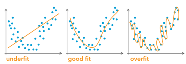

The objective in predictive modeling is to capture as many underlying patterns as possible while ensuring the model can generalize effectively to new data in the future. Predictive models rely on input data for learning. This input data is called training data. When building a model and training it on the input data, the goal is to achieve a general fit that captures the underlying patterns in the training data while maintaining great prediction performance on unseen, new data. The goal is not to replicate the training data perfectly, which will lead to overfitting. At the same time, avoid being excessively general, which can result in underfitting and missing key patterns in the data.
Graphs demonstrating data that is underfit, overfit, and a good fit

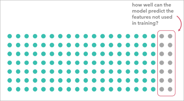

When developing a predictive model, we want to ensure that it performs well on unseen data (data that was not used to train the model). Achieving a good fit includes evaluating the model against reserved data where the true values of the predicted variable are known but the values were not used to train the model. This allows us to assess the model's performance on unknown data using various metrics. The reserved data containing these true values is commonly referred to as test data or validation data. Typically, the test data is separated from the training dataset and reserved specifically for model evaluation. The Prepare Data for Prediction tool facilitates the process of splitting input features into training and test sets for better model training.
A representation of a test-train split

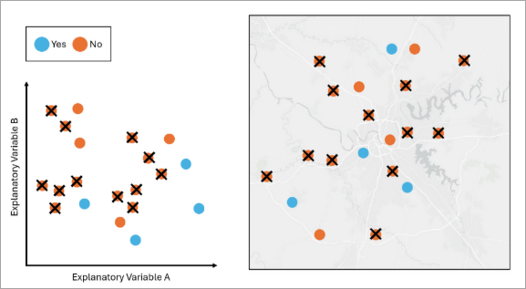

  • Random Undersampling—Random undersampling is a technique used to balance unbalanced data by randomly removing features from the nonminority classes until all classes have an equal number of features.
    A chart and map demonstrating random undersampling
    The features in blue are in the minority class and the features in orange are in the nonminority class. If we apply Random Undersampling to the data, the tool will randomly remove the orange features so that the number of orange features matches the number of blue features.

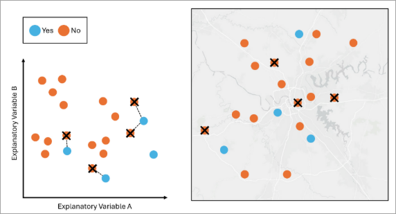

  • Tomek Undersampling—Tomek’s Link Undersampling is a technique used to balance unbalanced data by removing features from the nonminority classes that are close to the minority class in the attribute space. The purpose of this option is to improve the separation between classes and make a clear decision boundary for a tree-based model such as Forest-based and Boosted Classification and Regression. This option does not guarantee that all classes have an equal number of features.
    A chart and map demonstrating Tomek Undersampling
    The features in blue are in the minority class, and the features in orange are in the nonminority class. In the variable space, any pair of features from different classes that are nearest neighbors of each other is called Tomek’s Link. If we apply Tomek’s Undersampling to the data, the tool will remove the orange feature if it has a Tomek’s link with a blue feature.

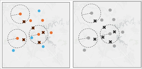

  • Spatial Thinning—Spatial thinning is a technique to reduce the effect of sampling bias on the model by enforcing a minimum specified spatial separation between features.
    When a categorical variable is selected as the variable to predict, the spatial thinning is applied to each group independently to ensure a balanced representation within each category; otherwise, it will be implemented across the entire training dataset regardless of attribute values.
    A chart and map demonstrating spatial thinning
    Any features that fall within a designated buffer distance will be removed.

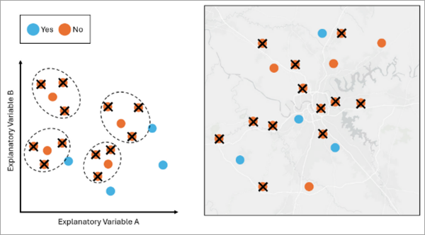

  • K-medoids Undersampling—K-medoids Undersampling is a technique used to balance unbalanced data by only keeping a number of representative features in the nonminority class so that all classes have an equal number of features. If we apply K-medoids Undersampling to the data, the tool will only keep K features that are medoids in the variable space from the nonminority class. Use K-medoids instead of another clustering algorithm to ensure that there is a central representative preexisting feature from each cluster.
    Learn more about K-medoids
    A chart and map demonstrating K-medoids undersampling
    The number of K is equal to the number of features in the minority class, which is 4. The clusters are created within each of the dependent variables’ classes and are clustered based on the values of the explanatory variables. The remaining features in the nonminority class come from the medoid of each cluster.

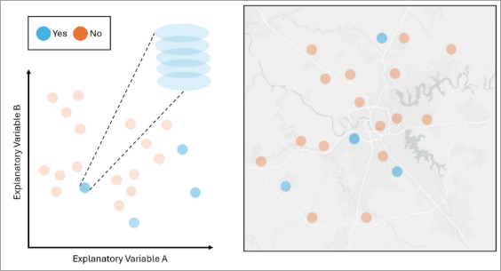

  • Random Oversampling—Random Oversampling is a technique used to balance unbalanced data by duplicating randomly selected features in the minority classes until all classes have an equal number of features.
    A chart and map demonstrating random oversampling
    The features in blue are in the minority class, and the features in orange are in the nonminority class. If we apply Random Oversampling to the data, the tool will randomly select and duplicate the blue features so that the number of blue features matches the number of orange features. The variables and the geography of a duplicated feature are the same as the original feature.

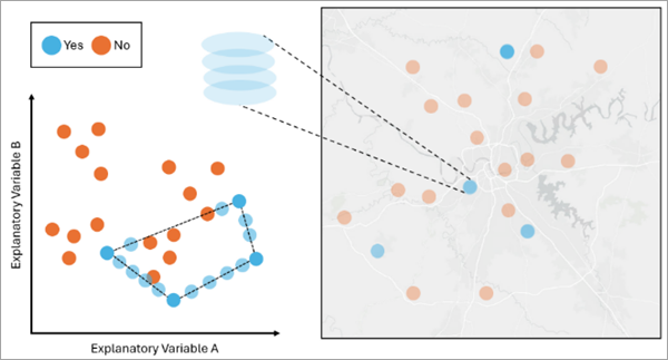

  • SMOTE Oversampling—SMOTE (Synthetic Minority Over-sampling Technique) oversampling is a technique used to balance unbalanced data by generating synthetic features in the minority class until all classes have an equal number of features. A feature in a minority class is chosen, a near feature of the same minority class in the attribute space is selected, and new attributes are generated as an interpolation between those two features. The geometry of the new synthetic feature will be that of the originally selected feature.
    A chart and map demonstrating SMOTE oversampling
    The features in blue are in the minority class, and the features in orange are in the nonminority class. If we apply SMOTE Oversampling to the data, the tool will generate the synthetic features by interpolating the values between two randomly selected features from the minority class in the attribute space. The geography of a synthetic feature is the same as the originally selected feature, while the variables are interpolated from the selected feature.

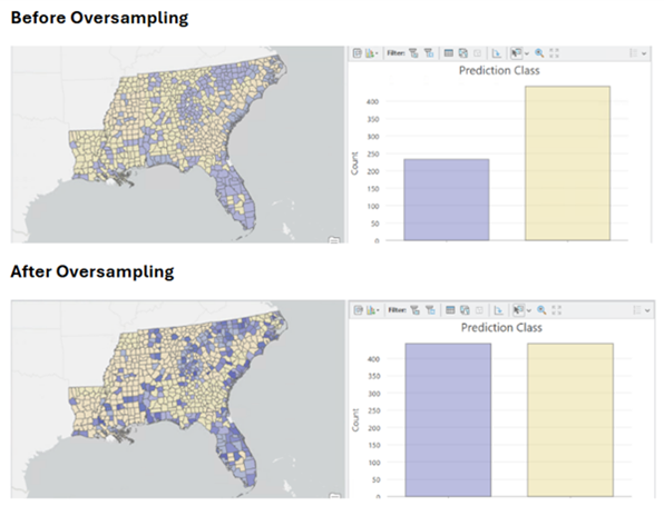

A map and chart demonstrating how oversampling affects the distribution of classes
An example of oversampling is shown. A map and chart of the distribution of categories in the training dataset show before oversampling (above) and after oversampling (below).
