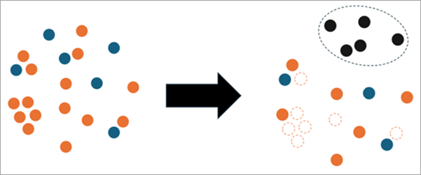

Enhances data for predictive workflows in the Forest-based and Boosted Classification and Regression, Generalized Linear Regression, and Presence-only Prediction tools, as well as other models. This involves splitting features into training and testing sets, extracting variables from rasters and distance features, balancing data for better classification accuracy, and conducting spatial thinning on biased spatial data.
Learn more about how Prepare Data for Prediction works
Illustration
Prepare Data for Prediction tool illustration
