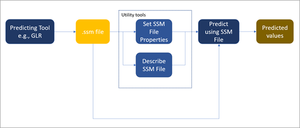

You can use the following tools to manage and predict with .ssm files:
  • Set Spatial Statistics Model File Properties—Set the properties of an .ssm file, including variable descriptions and units. This allows you to explain the variables of the model and their units so that others can use the file appropriately. For example, you can specify that an explanatory distance feature represents distances to hospitals measured in U.S. miles so that others can know to only use the model for a particular type of data.
  • Describe Spatial Statistics Model File—View the properties of an .ssm file, including the analysis method, dataset names, properties, and model diagnostics. This allows you to understand what each variable means so that you can correctly match all variables, datasets, and units when using the file to make predictions with new data.
  • Predict Using Spatial Statistics Model File—Use the .ssm file to make predictions with new datasets. You must match each variable or dataset in the .ssm file with a new dataset that has the same type and unit. For example, an explanatory variable in the model file may require a raster of temperatures values measured in degrees Celsius.

Spatial statistics model file workflow
