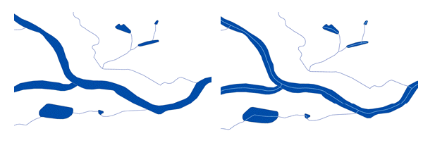

Summary
Creates centerlines from polygon features. This tool is useful for creating centerlines from hydrographic polygons for use at smaller scales.
Illustration
Polygon To Centerline tool illustration
