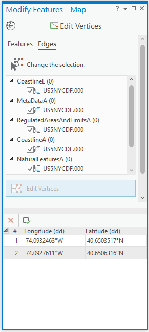

Click the Edit Vertices tool
.To find the tool, expand Reshape, or type Vertices in the Search text box.
Click the Edges tab.
ヒント:
To selectively highlight topological edges and nodes by hovering, set the display style to Select Elements. To learn more, see Configure map topology options.
The topology graph highlights in the map.
To move or delete a vertex, click Select edge or node
, and click the vertex you want to edit.The selection appears in the Edit Vertices pane.
The editing toolbar appears on the map.
To move a vertex, click and drag it using the pointer or right-click and use one of the following commands:

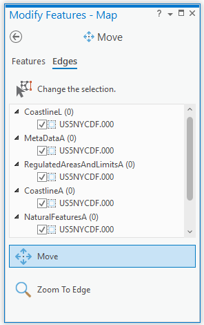

Move a topological edge
Use the Edges tab to select and move a topological edge and preserve its direction and length. Topologically connected edges stretch and remain connected.
To move a topological edge, complete the following steps:
ヒント:
To display the topology graph only when hovering over a feature, set the display style to Select Elements. To learn more, see Configure map topology options.
The topology graph displays in the map.

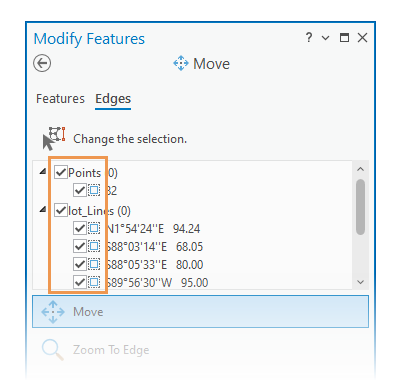

Click Select edge or node
and click the edge you want to edit.
In the selection view, review the check boxes for the selected edges and their origin layers.
To temporarily disable editing for a layer or an edge and keep them in the selection set, uncheck the corresponding check box.
To turn a selection on or off, click the select box. Alternatively, right-click a selected item and click Unselect
or Only Select This
ヒント:
To split a connection between one or more topological edges, disable editing for the feature or turn off the selection.
Hover near the edge you are editing and drag the edge when the pointer changes to the move or segment cursor.
To move the selection anchor, press Ctrl, hover over the anchor and drag it when the pointer changes to the directional cursor

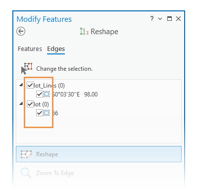

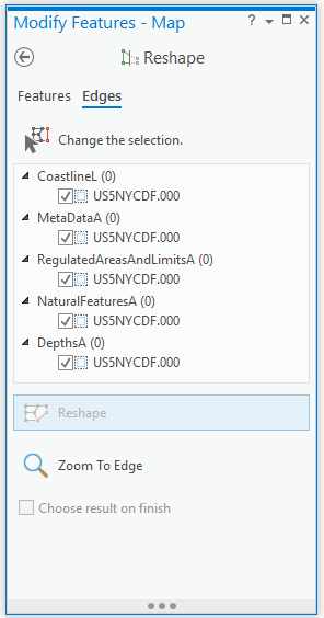

Click Select one or more edges
and click the edge you want to reshape.The selected edges appear in the selection view organized by layer and the pointer changes to the draw cursor.
The selection appears in the pane and is highlighted in the map. The editing toolbar appears with construction tools.
or Only Select This
Draw the new shape across the existing edge.
The new shape must cross or touch the topological edge in two or more places.
