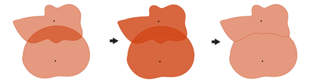

Trade area overlap methods
When removing overlap between polygons or polygon layers, you must select a method to resolve the overlap. Specify the method using the following options on the Method drop-down menu:
  • Thiessen—Divide the overlap using a straight line. This method identifies the centroid of an overlapped polygon and draws a dividing line such that the line is equidistant from each centroid. Any location inside the resulting polygon is closer to its centroid than any centroid in an adjacent polygon.
    Thiessen method
  • Center Line (default)—Distribute the overlapping area evenly between the polygons. Overlap is removed by creating a border that evenly distributes the overlapping area between polygons. This is the simplest method.
    Center Line method
  • Grid—Distribute the overlapping area using a grid of parallel lines that finds a natural division between the polygons. Overlap is removed by creating a grid of parallel lines used to define a natural division between polygons.
    Grid method
