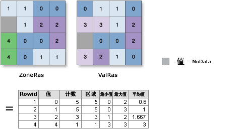

插图
以表格显示分区统计工具图示
ZonalStatisticsAsTable(ZoneRas, "Value", ValRas, OutTable, "DATA", "MIN_MAX_MEAN")
