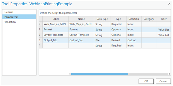

Script tool parameters
When using ConvertWebMapToArcGISProject in a web tool in ArcGIS Experience Builder, ArcGIS Maps SDK for JavaScript or ArcGIS Web AppBuilder, the parameter names of the script tool must match the Print task or Print widget parameters described in the following table:
Script tool parameter name
Data type
Type
Description
Web_Map_as_JSON
String
Required
A JavaScript Object Notation (JSON) representation of the state of the map to be exported as it appears in the web app. JSON is the format of the web map. It contains the full state of the web map (for example, layers, coordinate system, extent, scale, and so on). ArcGIS Experience Builder, ArcGIS Maps SDK for JavaScript and ArcGIS Web AppBuilder allow you to get this JSON string from the web app.
Output_File
File
Derived
The output file name. The extension of the file depends on the Format parameter.
Format
String
Optional
The format in which the map image for printing will be delivered. The following strings are accepted: PDF, PNG, PNG8, PNG32, JPG, GIF, EPS, SVG, and SVGZ.
Layout_Template
String
Optional
Either a name of a template from the list or the keyword MAP_ONLY. When MAP_ONLY is chosen or an empty string is passed in, the output map does not contain any page layout surroundings (for example, title, legends, scale bar, and so on).
The following screen capture shows a sample script tool's parameters:
Sample script tool parameters
Tipp:
When working with ArcGIS Maps SDK for JavaScript, any number of additional user-defined parameters can also be added. The ability to pass extra parameters into a custom Print task is useful, as it allows you to collect any number of extra parameters from the web app and pass them into the Python script. For example, your web app may have a control that allows users to choose whether to embed georeferencing information in the output PDF. For more information on collecting extra parameters, see example 3 in the Examples of using custom Python scripts in web apps section below.
For more information regarding setting script tool parameters, see Setting script tool parameters.

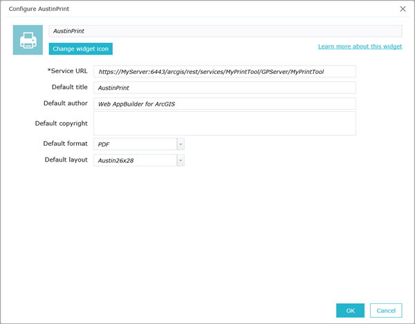

Example 2: Use a custom Python script in ArcGIS Web AppBuilder
After sharing the Python script tool as a web tool, the Print widget in ArcGIS Web AppBuilder is configured to use the REST URL of the web tool. The following screen capture shows the configuration dialog box for the Print widget:
The configuration dialog box for the Print widget
Tipp:
In the screen capture above, the values for Default format and Default layout are automatically populated from the Format and Layout_Template parameters from the web tool.
