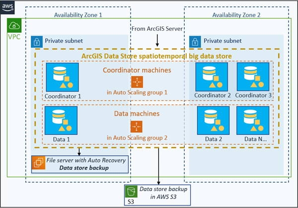

This template can create the following architecture in Amazon Web Services:
A spatiotemporal big data store cluster with one set of machines in the coordinator role in one Auto Scaling group and another set of machines in the data role in another Auto Scaling group
In the diagram above, backups are in an S3 bucket. Automatic backups can be created in an S3 bucket or an EC2 file server.
