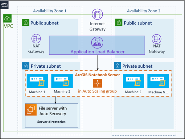

Deploy a highly available ArcGIS Notebook Server site using CloudFormation
The Esri arcgis-notebook-server-ha.template.json Amazon Web Services (AWS) CloudFormation template creates an ArcGIS Notebook Server site on multiple Linux Amazon Elastic Compute Cloud (EC2) instances to provide high availability.
The EC2 instances are deployed in an AWS Auto Scaling group, which offers advantages such as capacity planning based on certain criteria, better fault tolerance, better availability, and better cost management.
ArcGIS Notebook Server sites on AWS are only supported on Linux instances.
For specific operating system versions, see Operating systems supported when using CloudFormation to deploy ArcGIS on AWS.
This template can create the following architecture in Amazon Web Services:
ArcGIS Notebook Server site with EC2 instances in an Auto Scaling group and configuration store in cloud storage
License:
Certain icons in the diagram are used with permission from Amazon Web Services.
