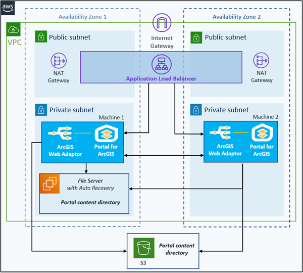

This template can create the following architecture in Amazon Web Services:
Portal for ArcGIS on a primary EC2 instance and secondary EC2 instance
In the diagram above, both a file server and an S3 bucket are shown for portal content directory storage. You will choose one location for the content directory when you launch this stack; the portal content directory is not stored in both places for the same portal.
