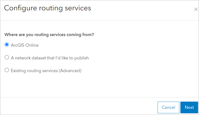

  5. Click Configure routing services and choose one of the three methods to configure routing services.
    Configure routing services dialog box
Use routing services from ArcGIS Online
You can configure ArcGIS Enterprise with routing services from ArcGIS Online. To do so, you must have an ArcGIS Online organizational account. The account must have credits associated with it and the appropriate permissions to use the routing services.
  1. On the Configure routing services dialog box, select the ArcGIS Online option, and click Next.
