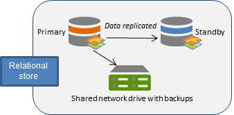

The relational store is always deployed in primary-standby mode. The first machine on which you install ArcGIS Data Store and create a relational store is the primary relational store machine. You can install and configure one other relational store with the same GIS Server site, making this second relational store machine the standby machine. Data is replicated from the primary to the standby machine.
In the following diagram, the orange data store is the primary. It replicates data to the standby (the blue data store), and writes backup files to a cloud storage location.

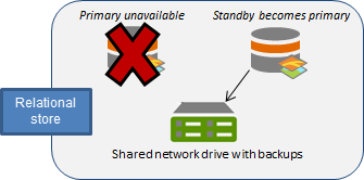

If the primary machine becomes unavailable (for example, if it crashes, loses power, or loses network connectivity), the standby machine is promoted to primary. You will only be without the data for the period of time it takes for the standby machine to become the primary—this can take up to a few minutes. Once the standby becomes the primary relational store machine, it sends its backup files to the same location as the former primary machine, as shown below.
Standby machine becomes primary when primary is inaccessible.

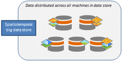

The spatiotemporal big data store is always deployed in cluster mode. You can install ArcGIS Data Store on several machines, create spatiotemporal big data stores on each, and register each one with the same hosting GIS Server site.
Data in the spatiotemporal big data store is duplicated on at least two spatiotemporal big data store machines registered to the same hosting server.
Spatiotemporal big data store containing five machines

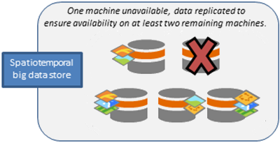

If any one machine fails, data still exists on at least one other machine. The data store replicates the data to another machine that is still functional.
One machine fails; data moved to remaining machines.

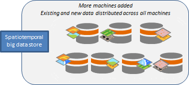

If the failed machine cannot be recovered, you can install ArcGIS Data Store on more machines and create spatiotemporal big data stores that are registered with the same hosting GIS Server site. In this example, three machines are added: one to replace the one that failed, and two more to accommodate increased numbers of hosted spatiotemporal feature layers. Data is rebalanced across all seven machines. Data for newly published spatiotemporal feature layers is also distributed.
Add machines to spatiotemporal big data store and data redistributes

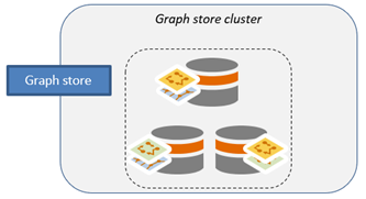

The graph store can contain one machine (single instance) or three or more machines (cluster). If you require a highly available graph store, configure a graph store that contains at least three machines.

If the cluster contains three machines, and a machine in the cluster fails, data still exists on at least one of the other machines in the cluster. At this point, the graph store is in an unhealthy, read-only state, but existing graph layers continue to function. If the failed machine recovers—for example, it was temporarily unavailable due to a network issue that was corrected—the graph store cluster returns to a healthy state.
If the failed machine cannot be recovered, you must do the following to maintain the required minimum three machines in the graph store cluster:
  • First, run the removemachine utility to remove the failed machine from the cluster. This marks the machine for deletion.
  • Configure a graph store on a new machine and add it to the cluster. The machine that was marked for removal is now unregistered from the graph store cluster.
If two machines in a three-machine cluster fail and cannot be recovered, the graph store is no longer functional. You cannot remove and replace the two machines. You must restore the graph store from a backup.
