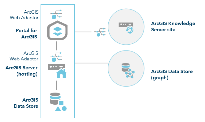

Federate an ArcGIS Knowledge Server site with a base ArcGIS Enterprise deployment after configuring an ArcGIS Data Store graph store on a separate machine.
The single-machine ArcGIS Knowledge Server site is federated with a base ArcGIS Enterprise deployment. ArcGIS Data Store is installed on an additional machine, created as a graph store, and configured with the hosting server.

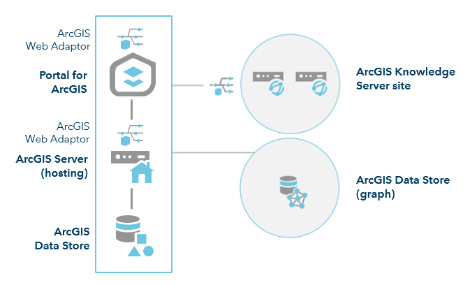

A two-machine ArcGIS Knowledge Server site can be federated with a base ArcGIS Enterprise deployment with an ArcGIS Data Store graph store.
A two-machine ArcGIS Knowledge Server site is federated with a base ArcGIS Enterprise deployment. ArcGIS Data Store is installed on an additional machine, created as a graph store, and configured with the hosting server.

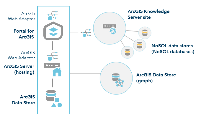

After configuring an ArcGIS Knowledge Server site, you can add a NoSQL data store to it to support a knowledge graph.

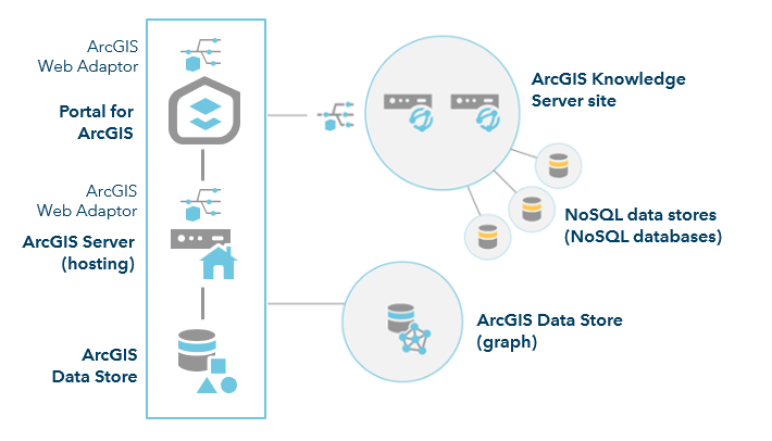

When you have configured a multimachine ArcGIS Knowledge Server site, you can add NoSQL data store items to the site.
After configuring a two-machine ArcGIS Knowledge Server site, you can add a NoSQL data store to the site to support a knowledge graph.
After configuring a two-machine ArcGIS Knowledge Server site, you can add NoSQL data stores to the site.
