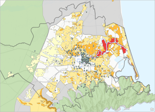

    The project opens with a map showing the urban area of Christchurch, New Zealand.
    Map of Christchurch urban area

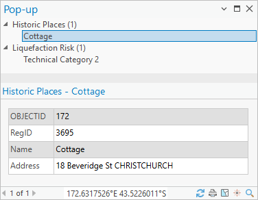

  5. On the ribbon, click the Map tab. In the Navigate group, click the Explore tool drop-down arrow and click Selected in Contents.

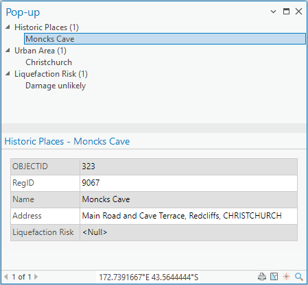

    When you click a location on the map, a pop-up will show the attribute values of features in the selected layers.
  6. At the bottom of the map view, click the map scale drop-down arrow and click 1:10,000 so that historic places are easier to distinguish.
  7. On the map, click a historic place.
    Pop-up showing feature attributes for both selected layers
    The pop-up displays the attributes of the historic place and the risk polygon that contains it.
    Tip:
    At the top of the pop-up, you see the display value, or primary attribute, for the features in both layers. In this example, a feature named Cottage is selected and its attributes are shown at the bottom of the pane. To see the attributes of the liquefaction risk feature, click the value under Liquefaction Risk at the top of the pop-up.
  8. Click a few more historic place features, then close the Pop-up pane.
    The pop-up shows the information of interest: the risk category associated with each historic place. However, clicking features one at a time is not the most efficient way to get this information. With a spatial join, you can add the liquefaction risk attributes to the Historic Places layer.

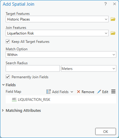

  1. In the Contents pane, right-click the Historic Places layer, point to Joins and Relates, and click Add Spatial Join .
    The Add Spatial Join tool opens in a floating window. The Target Features parameter is correctly set to the Historic Places layer.
  2. Click the Join Features drop-down arrow and click Liquefaction Risk.
    Attributes from this layer will be joined to the Historic Places table.
  3. Click the Match Option drop-down arrow and click Within.
    Each historic place will get the attributes of the liquefaction risk polygon it lies within. (In this case, the default match option of intersection would also work because a feature that is within another feature also intersects it.)
  4. Check the Permanently Join Fields check box.
    When the box is not checked (the default setting), the spatial join exists only in the current map and can be removed at any time. The source data of the target table is not modified. When the box is checked, the joined attributes modify the source data of the target table.
    You'll make the join permanent because later in the tutorial you'll append more features to the Historic Places layer. This can't be done when there is a temporary join on the layer.
    Tip:
    The Spatial Join geoprocessing tool can also be used for this workflow. The Spatial Join tool creates a new feature class with the attributes of the target and join features. The input datasets are not changed. In this tutorial, Add Spatial Join is used instead so that you can perform the join without creating a new output dataset.

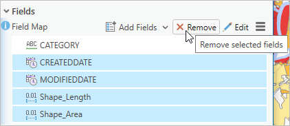

  5. Expand the Fields heading.
    The field map parameter displays a list of the fields in the Liquefaction Risk layer. The CATEGORY field is the only one of these fields you need to add to the Historic Places layer. You'll remove the others.
  6. In the list of fields, click the CREATEDDATE field to select it. Press the Shift key and click the Shape_Area field.
    Four fields are selected.
  7. Click Remove .
    Field map section of Add Spatial Join dialog box
    The selected fields are removed, leaving only the CATEGORY field.

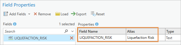

  8. In the field map parameter, click Edit .
    The Field Properties dialog box appears. At the top, under Properties, you see the properties of the CATEGORY field, such as its name, alias, and type.
  9. In the Field Name cell, highlight the existing value (CATEGORY) and replace it with LIQUEFACTION_RISK.
  10. In the Alias cell, highlight the existing value and replace it with Liquefaction Risk.
    Field Properties dialog box showing the new field name and alias
    The alias is a display name that appears by default in the attribute table and in most geoprocessing contexts. An alias can include spaces; a field name cannot.
  11. Click OK on the Field Properties dialog box.
  12. Click OK to run the Add Spatial Join tool.

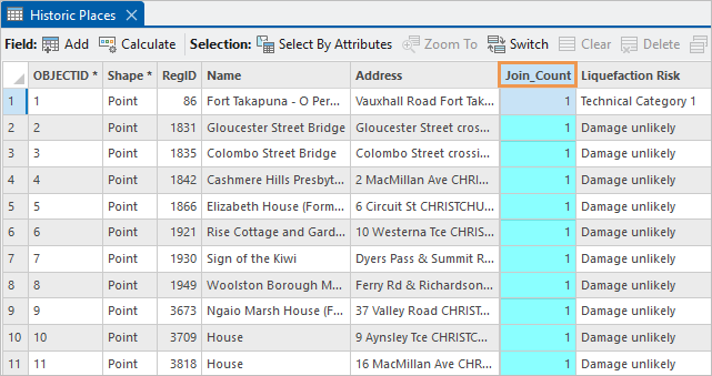

  13. When the operation is completed, in the Contents pane, right-click the Historic Places layer and click Attribute Table .
    The renamed Category field from the Liquefaction Risk layer is added to the table and displays its Liquefaction Risk alias. Each historic place is now associated with the risk category of the polygon in which it lies. A Join_Count field is also added. The value in this field is 1 for every record because each historic place is associated with exactly one risk polygon.
    You'll delete the Join_Count field, which you don't need.
  14. In the Historic Places table, click the Join_Count field heading to select the field.
    Attribute table with selected field
  15. Right-click the selected field heading and click Delete .
  16. On the Delete Field prompt, click Yes.

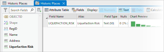

You'll open a Data Engineering view of the Historic Places table to view statistics for the joined table and create a chart.
  1. In the Historic Places table, click the Liquefaction Risk field heading to select the field.
  2. Right-click the selected heading and click Explore Statistics .
    Data Engineering view of the Historic Places attribute table
    A Data Engineering view of the table opens and displays statistics for the LIQUEFACTION_RISK field:
    • The Count value is 322 (100%). This confirms that a liquefaction risk value exists for each historic place.
    • There are six unique values. The Liquefaction Risk table actually contains seven unique values. This means that there are no historic places in one of the risk categories. (Fortunately, it's the red zone.)
    • The mode, or most common value, is Nonresidential area.
    • The least common value is Technical Category 1.

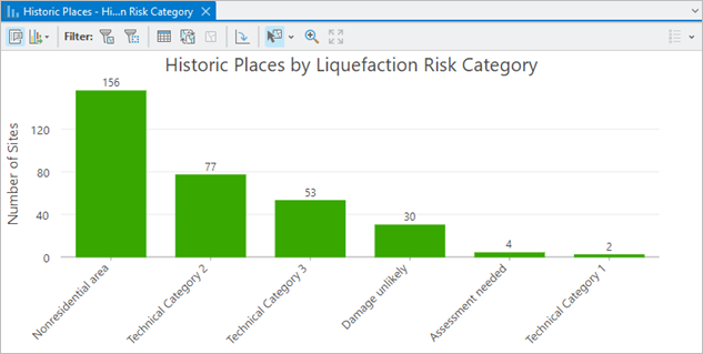

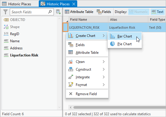

  4. Right-click the row header (the square at the left edge of the row), point to Create Chart , and click Bar Chart .
    Data Engineering view showing drop-down options for the LIQUEFACTION_RISK field

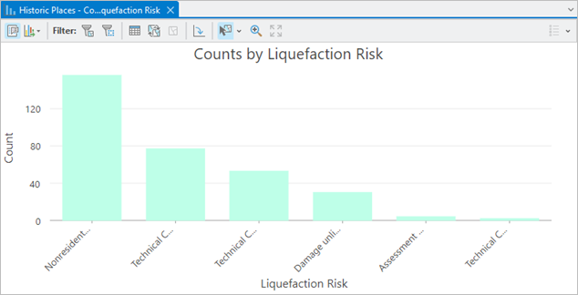

    A chart view and the Chart Properties pane appear. The chart displays the number of historic places in each risk category. You'll modify its properties to make the chart easier to interpret.
    Chart view with default settings
    The y-axis values and the orientation of the category labels may be different depending on the size of your chart view.
  5. At the top of the Chart Properties pane, confirm that the Data tab is selected.
  6. Under Data Labels, check the Label bars check box.
    On the chart, the number of historic places in each risk category appears above each bar.
  7. At the top of the pane, click the Axes tab.
  8. In the Label character limit box, change the value from 11 to 20. (You can use the arrow key or type the value and press the Enter key.)
    On the x-axis, the category values display their full names. By default, the label orientation is adjusted to best fit the available space. However, you may want to change the orientation.
  9. Optionally, click the Label orientation drop-down arrow and choose a setting that you like.
  10. At the top of the pane, click the General tab. (If you don't see it, click the options button and click General in the drop-down list.)
    1. In the Chart title box, delete the default title and type Historic Places by Liquefaction Risk Category. Press the Enter key.
    2. Uncheck the X axis title check box.
    3. In the Y axis title box, delete the default title and type Number of Sites. Press the Enter key.
    You may want to change the color of the bars, which is currently set to a light green.
  11. Optionally, click the Series tab.
    1. In the Symbol column, click the light green color square.
    2. On the color palette that appears, click any color you like.
    3. Click outside the color palette to close it.
    Chart of historic places by liquefaction risk category

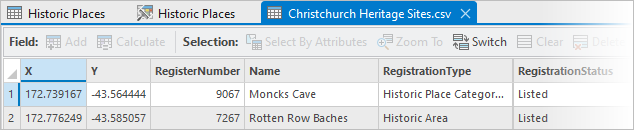

  4. In the Contents pane, right-click Christchurch Heritage Sites.csv and click Open .
    Christchurch Heritage Sites table
    The table contains information about two heritage sites, including a name, an address, a register number, and other fields.

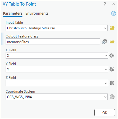

  6. Make the Christchurch Heritage Sites.csv table active again.
    The table includes X and Y fields with latitude-longitude coordinates in decimal degrees. You'll use these coordinates to create a layer from the table. Once you do that, you can see whether the features already exist in the Historic Places layer.
  7. In the Contents pane, under Standalone Tables, right-click Christchurch Heritage Sites.csv, point to Create Points From Table and click XY Table To Point .
    The XY Table To Point tool opens in a floating window.
    The Input Table parameter defaults correctly to Christchurch Heritage Sites.csv. The X Field and Y Field parameters default correctly to the X and Y fields in the table. The Coordinate System parameter defaults to GCS_WGS_1984. Most latitude-longitude values are stored in this system.
    Tip:
    You can confirm that the setting is correct in this case by right-clicking the file in the Catalog pane and clicking View Metadata .
  8. Next to the Output Feature Class text box, click Memory Workspace . Change the output feature class path to memory\Sites.
    XY Table To Point dialog box
    You'll create the point features in a temporary memory workspace because you don't need to create output data. If it turns out that the features already exist in the Historic Places layer, you can discard this new layer. If they don't yet exist, you want to append them to the Historic Places layer. Either way, you don't need to save them to a new dataset.
    The path name memory\ specifies that the output is written to the memory workspace rather than to a feature class. When you end your ArcGIS Pro session, the memory workspace is cleared. The name Sites can be any name that you choose, but cannot include spaces.
  9. Click OK.

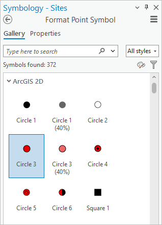

    You'll make the default symbols larger so they're easier to see.
  11. In the Contents pane, click the symbol for the Sites layer
    The Symbology pane appears with formatting options for point symbols.
  12. On the Gallery tab, in the list of symbols under ArcGIS 2D, click the Circle 3 symbol to select it.
    Symbology pane with Circle 3 symbol selected
    The symbol is updated on the map and in the Contents pane.

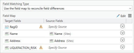

  4. Click the Field Matching Type drop-down arrow and click Use the field map to reconcile field differences.
    Field map parameter of the Append tool
    The dialog box expands to show the field map parameter. The names of the fields in the target dataset (Historic Places) are displayed.
    The RegID and LIQUEFACTION_RISK fields are marked with warning icons because they don't correspond to fields of the same name in the input dataset. (For this reason, the tool will fail if you run it with the default setting that input fields must match target fields.)
    However, as you saw earlier, the RegisterNumber field in the Sites table and the RegID field in the Historic Places table both contain historic registry numbers. When the field names differ but the values are compatible, you can manually match those fields using the field map.

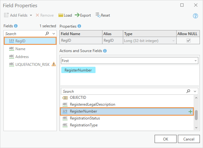

  5. In the field map parameter, click Edit .
  6. On the Field Properties dialog box, in the Fields list, confirm that the RegID field is selected (highlighted in blue). Scroll through the list of source fields and click the RegisterNumber field.
    Field Properties dialog box showing RegisterNumber field matched to RegID field
    Under Actions and Source Fields, the RegisterNumber field appears as a tag, indicating it is matched to the RegID field as a source field. The warning icon is removed from the RegID field.
    You'll leave the LIQUEFACTION_RISK field unmatched because it doesn't have a matchable field in the Sites table. When the tool runs, two new records will be added to the Historic Places table. Attributes will be processed as follows:
    • For matching fields, values in the Sites table will be added to the corresponding field in the Historic Places table. For example, addresses will be added to the Address field and registry numbers will be added to the RegID field.
    • Fields in the Historic Places table that don't have a matching field will have null values for the appended records. This means that the LIQUEFACTION_RISK field will have null values.
    • Fields in the Sites table that don't have a matching field will not be added to the Historic Places table. These include DateRegistered, LocalAuthorityName, and several other fields.

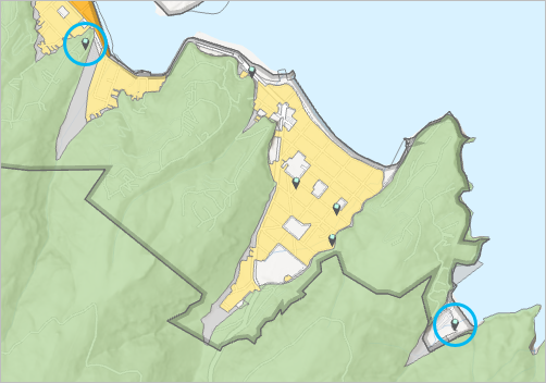

  11. Make the Christchurch Urban Area map view active. In the Contents pane, turn the Sites layer off.
    Map showing the two appended features
    The appended features appear on the map in the correct locations. You no longer need the Sites layer.

The new features were added after the spatial join and therefore have null values in the Liquefaction Risk field. You'll use the Explore tool to find the values for these features.
  1. On the ribbon, on the Map tab, click the Explore tool drop-down arrow and click Visible Layers.
  2. On the map, click the new feature in the Historic Places layer that represents Moncks Cave. (Of the two new features, this is the one farther north.)
    Pop-up showing values for visible layers
    On the pop-up, you see that Moncks Cave lies in a liquefaction risk zone in which damage is unlikely.
  3. Move the pop-up out of the way if necessary. On the map, click the new feature for the Rotten Row Baches.
    This feature lies in a nonresidential area.
    Note:
    If the Liquefaction Risk layer doesn't appear in the pop-up, zoom in on the feature and click it again. The feature lies at the edge of the layer extent. If you click outside the extent, you won't get a result.
  4. Close the Pop-up pane.

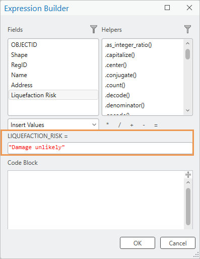

    Now you'll define the expression to calculate. In the Liquefaction Risk field, you want to replace the current null value for Moncks Cave with the value Damage unlikely.
  4. On the Calculate Field toolbar, click Expression Builder .
    The Expression Builder dialog box appears.
  5. On the Expression Builder dialog box, in the list of fields, click Liquefaction Risk.
    The Liquefaction Risk field contains the value you want to use. Selecting a field enables the Insert Values drop-down list.
  6. Click the Insert Values drop-down list and click Damage unlikely.
    Expression Builder dialog box with completed expression
    The completed expression is LIQUEFACTION_RISK = "Damage unlikely".
  7. Click OK.

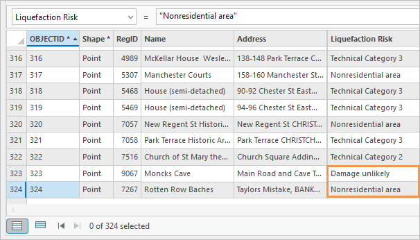

  8. On the Calculate Field toolbar, click Calculate Selected .
    The Moncks Cave record (the only selected record) is updated with its liquefaction risk value. You could update the Rotten Row Baches record in the same way, but this time you'll type the desired value in the expression box on the toolbar.
  9. In the table, click the number 324 row header to select the record for Rotten Row Baches.
  10. On the Calculate Field toolbar, in the expression box, delete the expression "Damage unlikely" and type, "Nonresidential area" (including the quotation marks).
    Calculate Field toolbar with expression
  11. Click Calculate Selected .
    The Rotten Row Baches record is updated.
  12. In the row of tools at the top of the table, click Clear to clear the selected record.
    Historic Places table with liquefaction risk values calculated for two new records
