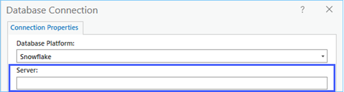

  3. Choose Snowflake from the Database Platform drop-down menu.
  4. Provide the name of the Snowflake account in the Server text box.
    Provide account information in the Server field.
    Provide the name in a format similar to my_account.snowflakecomputing.com.

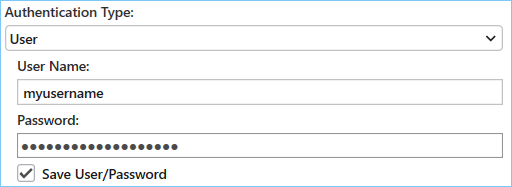

    • User—Provide a username and a password or programmatic access token used as a password.
      See the technical article What are Esri's recommendations to mitigate potential disruptions due to Snowflake's upcoming multi-factor authentication enforcement? for more information.
      If you will use the database connection file to publish web layers or use in geoprocessing models, you must check the Save User/Password check box.
      User authenticated connection

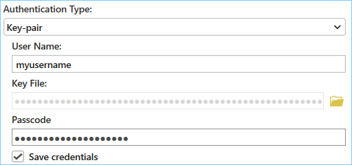

    • Key-pair—Type the username and specify the key file (.p8) configured for the user.
      Use key-pair authentication if you will register this connection file with an ArcGIS Server site.
      You must check the Save credentials check box if you will use the database connection file to publish web layers or use in geoprocessing models.
      Key-pair authentication with an encrypted key file
  6. If you provided an encrypted key file in the previous step, you must provide a pass code for the file, as shown in the image above.
