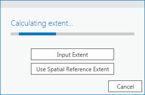

    • If you drag in a feature class, ArcGIS calculates the spatial extent of the data. If you add a table that contains a large number of features, extent calculation can take a while. If you know the extent of the data or want to use the extent of your spatial reference instead of waiting for ArcGIS Pro to calculate the extent, click the appropriate button on the Calculate Extent dialog box. If you click Input Extent, type a valid extent that includes all the features in the table. If you click Use Spatial Reference Extent, the data extent is set to the full extent of the spatial reference of the feature class.
