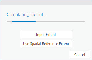

ArcGIS Pro calculates the extent of the layer when you drag it into the map. When you add a table that contains a lot of features, extent calculation can take a while. If you know the extent of the data or want to use the extent of the feature class's spatial reference instead of waiting for the extent to be calculated, you can do so. Click the appropriate button on the Calculate Extent dialog box. If you click Input Extent, you must type a valid extent that includes all the features in the table.
Alternate ways to calculate extent

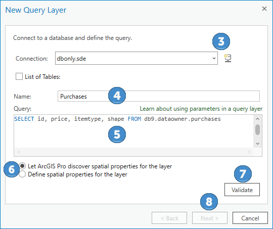

  1. In ArcGIS Pro, open the map to which you want to add the query layer.
  2. Click the Add Data button in the Layer group on the Map ribbon, and choose Query Layer from the drop-down menu.
    The New Query Layer dialog box appears.
  3. Specify a database by doing one of the following:
    • If the connection file (.sde) that accesses the database exists in the project, choose it from the drop-down list.
      Note:
      The database connection file must be in the project; otherwise, it will not appear in this list.
    • If the connection file does not exist in the project, click the new database connection button and create a connection. After you create the connection, choose it from the drop-down list.
    • Choose the SQLite (.sqlite), GeoPackage (.gpkg), or mobile geodatabase (.geodatabase) file from the drop-down list.
      Note:
      The file must be in the project; otherwise, it will not appear in this list.
  4. In the Name text box, provide a name for the query layer to be created.
    This is the name that will appear in the Contents pane of the map.
  5. Type or paste an SQL query in the Query text box.
    To see a list of tables and their columns, check the List of Tables check box. You can double-click a table in the List of Tables section to add all the columns in the table to the Query text box and edit the query in the Query text box. For example, you can delete the columns from the query that you do not want included and add clauses to the query to limit the data included in the query layer.
  6. Choose how the layer's spatial properties will be defined.
    • Choose Let ArcGIS Pro discover spatial properties for the layer (the default option) to allow ArcGIS Pro to use the spatial properties of the first row returned by the query. ArcGIS Pro discovers these properties when you validate the SQL statement.
    • Choose Define spatial properties for the layer if you want the layer to include features with spatial properties that are different than those of the first row.
  7. Click Validate to ensure that the query syntax is correct and that ArcGIS can use the query.
    The validation process runs the query in the database to confirm that the result set from the query meets the data modeling standards enforced by ArcGIS. A query layer is not added to the map until it is valid.
    Rules for validation are as follows:
    • The result set must have, at most, one spatial field.
    • The result set must have, at most, one spatial reference.
    • The result set must have only one shape type.
    • The result set cannot have any field types not supported by ArcGIS.
    If the validation fails for any reason, an error message is returned so you can modify the query.
    Validation is especially important when working with data in spatial databases that do not enforce the same standards as ArcGIS.
  8. When the query passes validation, click Next.

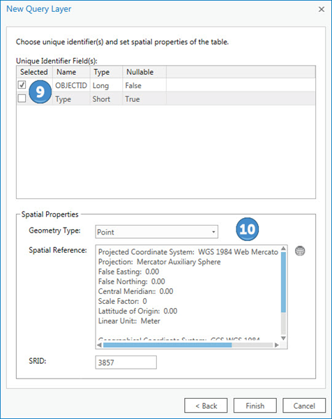

  9. Select the unique identifier field for the query layer or use the field that ArcGIS Pro selected.
    All features in the map need a unique identifier. Therefore, the query layer must contain a unique identifier field that contains a value for each feature. Learn more about choosing a unique identifier field for a query layer.
  10. Select the geometry type and spatial reference.
    These parameters may already be set if you chose to allow ArcGIS Pro to define the spatial properties.
    1. Choose the geometry type from the drop-down menu.
    2. Click the Coordinate System button to choose the coordinate system of the spatial reference used by the data, or import the spatial reference from an existing dataset. This does not reproject the data.
    Specify the unique ID, geometry type, and coordinate system for the spatial reference.
