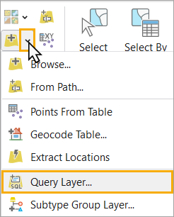

  1. Open the map in ArcGIS Pro to which you want to add the query layer.
  2. Click the arrow on the Add Data button in the Layer group on the Map ribbon and choose Query Layer from the drop-down menu.
    Expand the Add Data menu and choose Query Layer.
    The New Query Layer dialog box appears.
