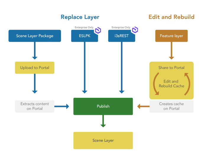

Sources of scene layers
Deployment and data management options for scene layers are shown.
