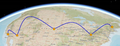

    Animation using Hop transition
    An animation using Hop transition to tour five cities across the United States is shown.
Tip:
Click the Path button in the Display group on the Animation tab to get visual feedback of the hop height.

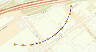

Fly along a path in a map or scene
A fly along a path animation simulates the camera moving through a map or scene along a predetermined path. Examples include a 3D panning along a pipeline path or 2D panning along a proposed culvert route. A fly along a path animation is usually best served by direct steps between keyframes using a linear transition, but be aware that this creates simulated bumps when the camera changes direction.
To add a fly-along to a map or scene, ensure that the Animation tab is open. If necessary, click Add Animation in the Animation group on the View tab. Then, in the Create group, on the Animation tab, click the Import drop-down menu and click Fly Along Path .
Note:
  • This method is only available when a single linear feature is selected.
  • Keyframes are created at every vertex of the selected linear feature.
  • The use of multipart linear features is not recommended.
  • For best results, it is recommended that linear features are simplified and flow in one direction.
