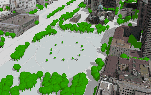

Visibility coverage using interactive viewshed
A common 3D spatial challenge is placing a limited set of resources in a scene to get the best possible visibility coverage. For example, you might need to place security cameras to monitor a park, film cameras throughout a sporting event, or police officers around a political rally. In all these cases, you want to optimize their locations to avoid missed coverage and reduce areas with double coverage.
This scenario describes camera placement around a park. The best exploratory analysis tool for this work is the Interactive Viewshed tool. Begin with a scene containing relevant layers, such as a ground surface, buildings, and trees.
Example viewshed analysis
  1. Choose Viewshed from the Exploratory 3D Analysis drop-down list of tools in the Workflows group on the Analysis tab.
    The tool is now active and the Exploratory Analysis pane appears.
  2. On the Create tab, set values for Initial Viewpoint, Viewshed Angles, and Viewshed Distance based on the security camera's specifications. For example, a camera might have a maximum visibility range of 200 feet, a horizontal field-of-view angle of 50 degrees, and a vertical field-of-view angle of 40 degrees for the viewshed.
  3. Accept the default creation method, Interactive Placement .
  4. Press C to temporarily activate the Explore tool and navigate to the area of interest. Release C and click in the scene to place a viewshed.
  5. Repeat steps 3 and 4 to create additional camera observer positions as needed.
  6. Inspect the visibility coverage as you add each additional camera. Red areas remain uncovered.
  7. Optionally, select an observer point for an existing viewshed object and reposition it with the handles.
  8. When you have a design that works well, save the current observer locations to point features by clicking Convert To Features from the menu in the Exploratory Analysis pane.
You now have a design with well-defined coverage stored as attributed point features for the camera locations. You can symbolize the camera locations using physical camera models, such as a COLLADA (.dae) or OBJ (.obj) file, and visualize how they would appear in the real world. You can also reload the viewsheds from this point layer to revisit or update the viewshed coverage in the future.

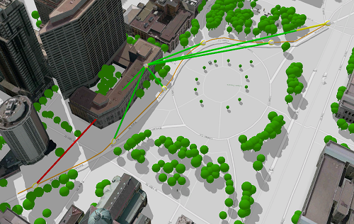

Line of sight along a route
In this scenario, an unobstructed line of sight is maintained from a viewpoint using regularly spaced target points along a route. This can be important for many reasons; for example, you might want to position a public official to observe a parade route, a commentator to watch a sporting race, or a military spotter for a convoy. In each of these cases, you want to know both where and how much of the route the observer can see. The best exploratory analysis tool for this work is the Line of Sight tool. Begin with a scene containing all the relevant layers, such as a ground surface, buildings, and trees.
Example lines of sight
Lines of sight from a viewpoint using regularly spaced targets along a route. Green lines are unobstructed, red (left) is obstructed, and yellow (upper right) is out of range.
  1. Add a line layer to your scene to use as the parade route. A single long line may need to be split into smaller pieces to create a section of parade route that makes sense for the observer to be responsible for. For example, split the line to work with a street segment about 250 meters long.
  2. Click Line of Sight from the Exploratory 3D Analysis drop-down list of tools in the Workflows group on the Analysis tab.
  3. On the Create tab, set values for the following parameters:
    • Observer Vertical Offset—5 feet, the height of a standing person
    • Maximum Distance—150 meters, the maximum effective viewing distance
    • Target Vertical Offset—3 feet, the target height for the base of the parade float
  4. Click the Targets Along a Line creation method to view the settings.
  5. Leave the Observer input as Click and click once in the view to place the observer location. Common locations are building rooftops, balconies, and street corners.
  6. Set the Number of Targets to 10 to generate the target points along the route. Alternatively, you can set the Segment Length spacing to 25 meters to generate the target points.
  7. Select the line layer from the drop-down menu to use as your parade route.
    The Select tool is enabled for the next step.
  8. Click and drag in the view to select one or more line features for the target points.
    Note:
    Multiple contiguous lines are processed as a single route where possible.
  9. Click Apply.
  10. Optionally, click the observer point and move it to a different viewpoint.
    The targets remain in the same location and remain connected to the observer point. Green lines indicate the sections of the route that are within view of the observer.
  11. When you have a design that works well, save the current sight lines as two-point line features by clicking Convert To Features from the menu in the Exploratory Analysis pane. The view lines are added to the scene as a feature layer.
You now have a 3D view that visually describes how much of the route can be seen from one or more observer points. Reload the line of sight analysis objects using the From Layer creation method.
