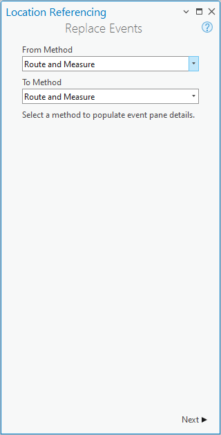

Open a map in ArcGIS Pro, and zoom to the location where you want to replace events.
On the Location Referencing tab, in the Events group, click Replace
.The Replace Events pane appears.
Route and Measure is the default method in the From Method and To Method drop-down menus.
Choose the methods to locate the events to replace from the From Method and To Method drop-down lists.
Note:
You can use a combination of any of the event replacement methods to locate the From measure and To measure. For example, you can use Route and measure to choose the From measure value, and use Coordinates to define the To measure value along the route on the map.
Click Next.

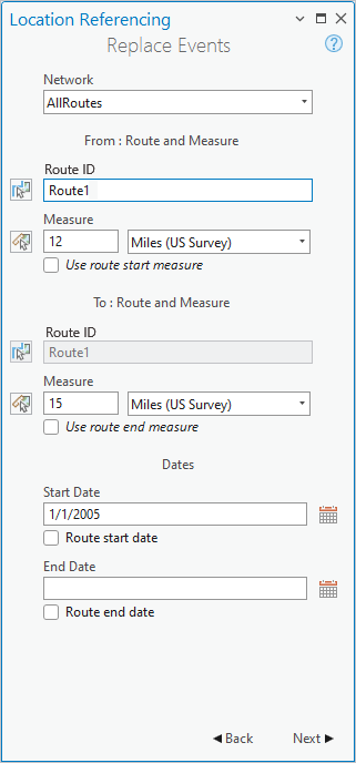

In the From: Route and Measure section, specify the route by doing either of the following:
Provide the route ID in the Route ID text box.
Click Choose route from map
, and click the route on the map.
In the From: Route and Measure section, provide the measure by doing any of the following:
Provide the start measure in the Measure text box.
Click Choose measure from map
, and click the start measure location on the map.Check the Use route start measure check box to use the route's start measure as the From measure value for the event replacement.
A green dot appears at the selected location on the map.
Optionally, in the From: Route and Measure section, choose a unit of measurement using the drop-down arrow.
In the To: Route and Measure section, specify a route by doing either of the following:
Note:
If there is only one route, the text box in this section is inactive.
, and click the end measure location on the map.
In the To: Route and Measure section, do one of the following to specify the end measure for the event replacement along the route:
Provide the end measure in the Measure text box.
, and click the end measure location on the map.Check the Use route end measure check box to use the route's end measure as the To measure value for the event replacement.
A red dot appears at the selected location on the map.
Note:

Optionally, in the To: Route and Measure section, choose a unit of measurement using the drop-down arrow.
Specify the date to define the start date of the events that are replaced by doing one of the following:
Provide the date in the Start Date text box.
Choose the start date using the Calendar
.Check the Route start date check box to use the route start date.
Note:
The start date is used as follows:
Retirement Date—For events in the Retire Events list
Retirement Date—For events in the Retire and Replace Events list
Start Date—For the replacement events in the Retire and Replace Events list
Optionally, specify the date to define the end date of the events that are replaced by doing one of the following:
Provide the date in the End Date text box.
Choose the end date using the Calendar
.Check the Route end date check box to use the route end date.
Note:
The end date is used as the end date for the replacement events in the Retire and Replace list.
Click Next.

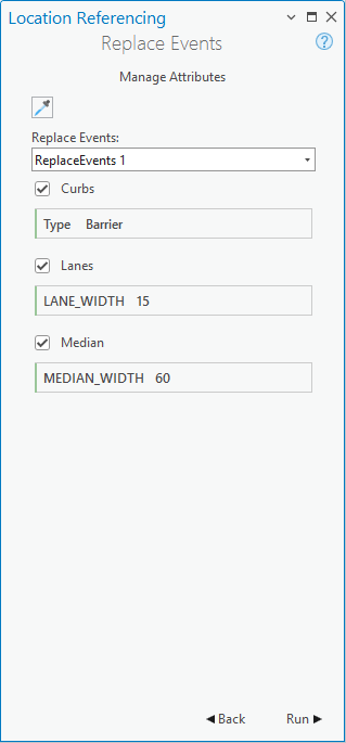

The Manage Attributes section appears.
Note:
If no events are configured for retirement or for retirement and replacement, a message appears.
Click the Replace Events drop-down arrow, and choose an event replacement configuration.
The editable attributes for each of the configured event layers are listed. Events configured for retirement are not listed because they are not replaced.
Tip:
If you don't want to retire an event, update the configuration to leave it as is. To leave an event as is, it must not appear in either the Retire Events list or the Retire and Replace Events list before event replacement is run.
Provide the replacement values in the attribute fields.
Click Run to complete the event replacement for the specified route or route segment.
The events in the Retire Events list are retired.
The events in the Retire and Replace Events list are retired, re-created, and displayed on the map.
