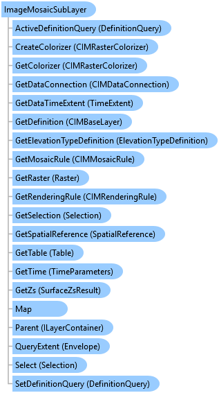

    Object Model
    ImageMosaicSubLayer ClassDefinitionQuery ClassCIMRasterColorizer ClassCIMRasterColorizer ClassCIMDataConnection ClassTimeExtent ClassCIMBaseLayer ClassElevationTypeDefinition ClassCIMMosaicRule ClassRaster ClassCIMRenderingRule ClassSelection ClassSpatialReference ClassTable ClassTimeParameters ClassSurfaceZsResult ClassMap ClassILayerContainer InterfaceEnvelope ClassSelection ClassDefinitionQuery Class
