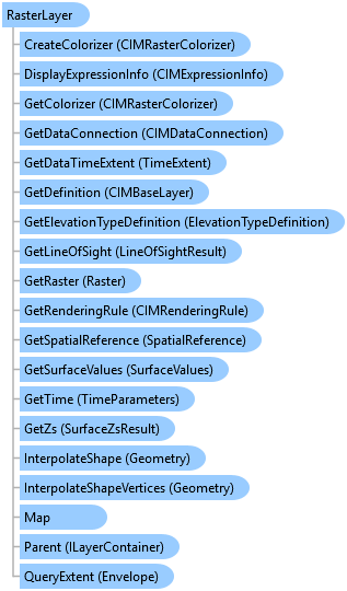

    Object Model
    RasterLayer ClassCIMRasterColorizer ClassCIMExpressionInfo ClassCIMRasterColorizer ClassCIMDataConnection ClassTimeExtent ClassCIMBaseLayer ClassElevationTypeDefinition ClassLineOfSightResult ClassRaster ClassCIMRenderingRule ClassSpatialReference ClassSurfaceValues ClassTimeParameters ClassSurfaceZsResult ClassGeometry ClassGeometry ClassMap ClassILayerContainer InterfaceEnvelope Class
