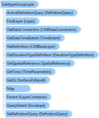

    Object Model
    SubtypeGroupLayer ClassDefinitionQuery ClassLayer ClassCIMDataConnection ClassTimeExtent ClassCIMBaseLayer ClassElevationTypeDefinition ClassSpatialReference ClassTimeParameters ClassSurfaceZsResult ClassMap ClassILayerContainer InterfaceEnvelope ClassDefinitionQuery Class
