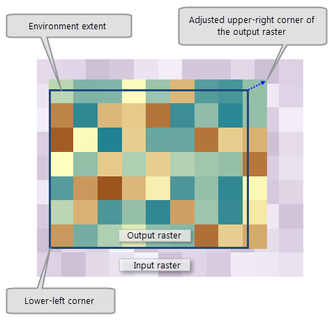

The Extent environment is used to control where the image processing occurs. Tools that honor the Extent environment will only process image pixels and input features that fall within the extent.
When you define an output extent, the lower left corner of the specified extent will be the lower left corner of the output raster, unless you have also specified a Snap Raster environment.
From there, the upper right corner of the output image is adjusted in such a way that the specified extent falls within the output image. Whether the upper right corner will be adjusted or not is determined by the output pixel size. The width and the height of the output image extent are multiples of the output pixel size. The end result is that the extent of the actual output image can be slightly larger than what is specified in the Extent environment.
If the lower left corner of the output extent does not match any pixel corner of the input raster, it will create a shift in the pixel alignment between the input and output images and rasters. This difference of pixel alignment will trigger a resampling of the input image to perform analysis. For most of the Spatial Analyst tools, the Nearest Neighbor resampling technique is used, apart from the Surface tools, which use Bilinear Interpolation.
