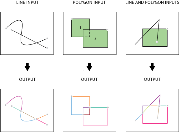

Illustration
Feature To Line tool illustration

  • Where input lines or polygon boundaries touch, cross, or overlap each other at locations other than their start and end vertices, they will be split at those intersections; each of the split lines will become an output line feature. If an input line or polygon boundary is not intersected by another feature, its entire shape will still be written out as a line feature.
  • For multipart input features, the output lines will be singlepart.
  • For input features that are parametric (true) curves, the output lines will remain true curves even if they are split. This does not apply to shapefile data.
  • If the Preserve attributes parameter is checked, the attributes from all input entries will be maintained in the output in the order they appear in the input list. A new field, FID_xxx, where xxx is the source feature class name of a particular input entry, will be added to the output for each input entry and set to the source feature IDs. The output lines are associated with their attributes in the following ways:
    • For coincident lines or polygon boundaries within the same set of input features, for example, the boundary separating two polygons, two line features with identical geometry will be written to the output: each of them will have the attributes of its source feature.
    • For coincident lines or polygon boundaries from two different sets of input features, for example, a line overlapping a polygon boundary, only one line feature with the attributes of both source features will be written to the output.
    • If an output line does not overlap any feature in a particular input feature set, it will have the value of -1 in the FID_xxx field and zero or null values in the other fields from that feature set.
    If the Preserve attributes parameter is unchecked, none of the input attributes will be maintained in the output feature class; a single line feature will be written to the output for each set of coincident lines or polygon boundaries.
