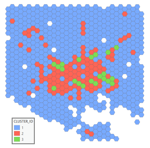

A number of outputs are created by this tool. A 2D feature class showing each location in the Input Space Time Cube, symbolized by its cluster membership allows you to explore any spatial patterns. Even though the clustering algorithms used in this tool do not take any spatial relationships into account when performing the clustering, there may still be spatial patterns present. In addition, messages summarizing the analysis results and Mann-Kendall trend statistics for each cluster are written at the bottom of the Geoprocessing pane during tool execution. You can access the messages by hovering over the progress bar, clicking the pop-out button , or expanding the messages section in the Geoprocessing pane. You can also access the messages for a previously run tool using geoprocessing history.

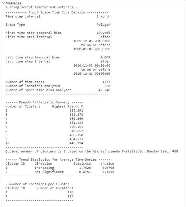

Time Series Clustering messages window
The default output of the Time Series Clustering tool is a new output features class containing the CLUSTER_ID field, which indicates to which cluster each location belongs. This output feature class is added to the Contents pane with a unique color rendering scheme applied to the CLUSTER_ID field. The CENTER_REP field indicates which locations in the space-time cube are most representative of each cluster (called the medoids of the clusters). This field will contain a value of 1 for the medoid of each cluster, and all other locations will contain a value of 0.
Time Series Clustering result
Example of the results of the Time Series Clustering tool

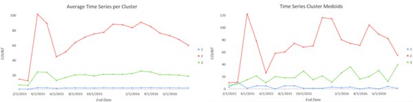

Charts are produced when you create an Output Table for Charts. The Average Time Series per Cluster chart displays the average of Analysis Variable at each time step for each cluster, and the Time Series Cluster Medoids chart displays the medoid time series of each cluster. Together, these charts allow you to visualize both the overall average and the representative time series broken down by cluster. This is analogous to summarizing the categories of a univariate dataset using the mean and the median.
Time Series Clustering output charts

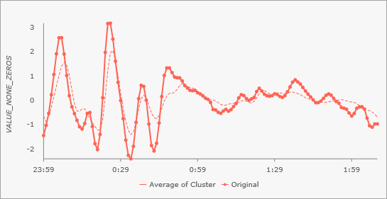

You can also use the Enable Time Series Pop-ups parameter to create time series charts in the pop-ups of each output feature that show the time series of the feature and the average time series of all features in the same cluster. This allows you to see how the time series of the feature compares to other features in the same cluster and how well it is represented by the cluster.
Time Series Clustering pop-up chart

When you leave the Number of Clusters parameter empty, the tool will evaluate the optimal number of clusters, and the value will be reported in the messages window. Determining the number of clusters is one of the most difficult aspects of clustering workflows, and this tool identifies an optimal number by trying different numbers of clusters and identifying the one that results in the most effective clustering.
The tool will try each value between 2 and 10 numbers of clusters, and it will repeat each value 10 times using random starting values in the clustering algorithms. If Profile (Correlation) is used with more than 10,000 points, the CLARA algorithm will instead run 20 times for each of the 9 possible numbers of clusters. For each of these 90 (or 180) clustering results (10 or 20 from each of the 9 possible numbers of clusters), a pseudo-F statistic is calculated by dividing the squared errors to the global medoid by the squared errors to the cluster medoids, correcting for the use of larger numbers of clusters. This can be interpreted as the ratio of between-group similarity to within-group similarity. Larger values of the pseudo-F statistic indicate that the time series are more similar to the representative time series of their cluster than they are to the representative of the entire dataset, which indicates effective clustering. For more information, along with formulas for calculating the pseudo-F statistic, see How Multivariate Clustering works.
