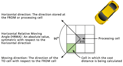

  1. First, the prevailing horizontal direction must be established. A horizontal direction is defined in degrees, with 0 being above, or north, of the processing cell and the values increasing clockwise, creating a circle and returning to itself at 360 degrees.
    Path Distance direction compass
    The horizontal direction is defined by a value assigned to each cell location on the input horizontal factor raster. It often identifies the direction with the lowest horizontal cost of movement with respect to the processing cell, but this does not necessarily have to be the case.
    Path Distance wind component

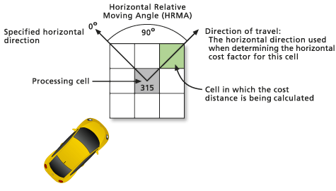

  2. Once the horizontal direction has been defined, the horizontal factor used in calculating the total cost of moving along the segment must be determined. First, the position of the to cell relative to the horizontal direction must be ascertained. The direction of the to cell relative to the prevailing horizontal direction at the from cell is the horizontal moving direction, or just the moving direction. The number of degrees or angle of the to cell from the horizontal direction as defined by the horizontal factor raster is the horizontal relative moving angle (HRMA).
    Path Distance with HRMA of 315
    The number of degrees from the established horizontal direction, not which side of the established direction, is of relevance.
    Path Distance with HF of 90
Once the HRMA has been determined, a graph is used to identify the actual horizontal factor. The HF is on the y-axis, and the HRMA is on the x-axis.
In the example above, if the cell whose horizontal factor you are calculating has an HRMA of 90 degrees from the horizontal direction as defined by the processing cell on the input horizontal factor raster, the horizontal factor cost will be 1.61.
