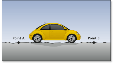

More fuel will be needed to drive the same car from point A to point B if it has to travel on a rough or bumpy surface, such as an unpaved road. The amount of fuel used in the second instance is calculated by the distance traveled over the friction, which is the friction factor (F), to compensate for the bumpiness of the surface, times the distance to travel divided by the miles per gallon the car gets on flat, smooth surfaces (D = Miles traveled / Miles per gallon), resulting in the following formula:
F * D = Fuel Used
Extra energy is expended traveling on a bumpy road
Extra energy is expended traveling on a bumpy road.
The above formula can also be used in the first example, but the friction factor was much lower than in the second example because the car traveled on a smooth surface.

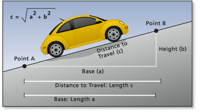

If the route from point A to point B was uphill, the car would have to travel farther in actual distance than if the route were flat. (You can ignore for the moment the fact that additional fuel would be necessary to propel the car uphill.) The distance that would be traveled is referred to as the surface distance (SD).
Extra energy is expended when going uphill
Extra energy is expended when going uphill.
The surface distance extends the actual travel distance over the type of travel surface. Continuing the preceding example, the car now must travel on the bumpy surface for a longer distance. The surface distance (SD) increases the total cost of travel as a factor, not by simple addition. When considering surface distance (SD replaces D), the following formula is used:
F * SD = Fuel Used

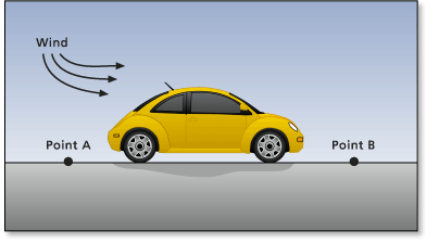

Another group of elements that might influence a car's consumption of energy is the horizontal factors. These factors consider the easiest horizontal route to travel and how far from it the car is traveling. One horizontal factor in this example could be wind speed. If there is a strong wind behind the car, it will use less fuel to move from point A to B, regardless of the surface and actual travel distance.
Less energy is expended travelling with a tailwind
Less energy is expended traveling with a tailwind.
Including the horizontal factor (HF) in the total cost of travel results in the following formula:
F * SD * HF = Fuel Used

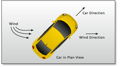

The horizontal factor related to wind speed must be adjusted to compensate for the amount of horizontal friction that will be encountered with regard to the relationship of direction of travel and wind direction. For example, if the wind is blowing behind the car at a 45-degree angle offset, the wind will be of some advantage to the car but not as much as if blowing directly behind it (a 0-degree offset).
The wind direction affects energy expenditure depending on the angle (crosswind)
The wind direction affects energy expenditure depending on the angle (crosswind).
If the car is heading directly into the wind, the horizontal friction factor would be greatest.

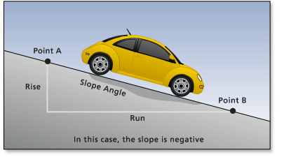

The final factor that will affect the energy consumption of the car is the uphill or downhill slope that must be overcome during travel, which is called the vertical factor. In this example, if the car is going downhill, the total cost of travel will decrease; if it is going uphill, the total cost will increase.
Less energy is expended going downhill
Less energy is expended going downhill.
Incorporating the vertical factor (VF) into the previous formula results in the following formula:
F * SD * HF * VF = Fuel Used
