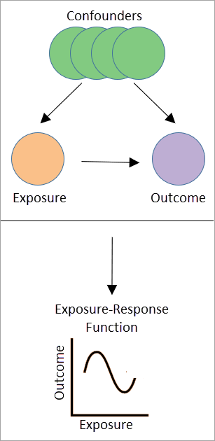

Illustration
Causal Inference Analysis tool illustration
The causal effect between an exposure and outcome is estimated by balancing confounding variables.
