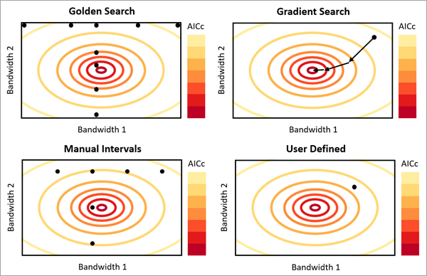

There are four options for the Neighborhood Selection Method parameter that can be used to estimate the optimal spatial scale for each of the explanatory variables:
Neighborhood selection methods
  • Golden Search—Determines either the number of neighbors or distance band for each explanatory variable using the Golden Search algorithm. This method searches multiple combinations of values for each explanatory variable between a specified minimum and maximum value. The procedure is iterative and uses the results from previous values to select each new combination to be tested. The final values selected will have the smallest AICc. For the number of neighbors option, the minimum and maximum are specified using the Minimum Number of Neighbors and Maximum Number of Neighbors parameters. For the distance band option, the minimum and maximum are specified using the Minimum Search Distance and Maximum Search Distance parameters. The minimum and maximum values are shared for all explanatory variables, but the estimated number of neighbors or distance band will be different for each explanatory variable (unless two or more coincidentally have the same spatial scale). This option takes the longest time to calculate, especially for large or high-dimensional datasets.
  • Gradient Search—Determines the number of neighbors or distance band for each explanatory variable using a gradient-based optimization algorithm. To find the optimal bandwidth of each explanatory variable, Gradient Search takes the derivative of the AICc with respect to the bandwidths and updates the bandwidths until it finds the lowest AICc. For the number of neighbors option, the minimum and maximum are specified using the Minimum Number of Neighbors and Maximum Number of Neighbors parameters. For the Distance Band option, the minimum and maximum are specified using the Minimum Search Distance and Maximum Search Distance parameters. Like Golden Search, the minimum and maximum values are shared for all explanatory variables, but the estimated number of neighbors or distance band may be different for each explanatory variable (unless two or more coincidentally have the same spatial scale). This option estimates comparable neighborhoods to Golden Search but has a better runtime performance and requires significantly less memory usage.
  • Manual Intervals—Determines the number of neighbors or distance band for each explanatory variable by incrementing the number of neighbors or distance band from a minimum value. For the number of neighbors option, the method starts with the value of the Minimum Number of Neighbors parameter. The number of neighbors is then increased by the value of the Number of Neighbors Increment parameter. This increment is repeated a certain number of times, specified using the Number of Increments parameter. For the distance band option, the method uses the Minimum Search Distance, Search Distance Increment, and Number of Increments parameters. The number of neighbors or distance band used by each explanatory variable will be one of the tested values, but the values may be different for each explanatory variable. This option is faster than Golden Search and frequently estimates comparable neighborhoods.
  • User Defined—The number of neighbors or distance band that is used by all explanatory variables. The value is specified using the Number of Neighbors or Distance Band parameter. This option provides the most control if you know the optimal values.

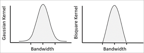

MGWR estimates a local regression model for each target feature by applying a geographical weighting (kernel) function to the feature and its neighboring features. Neighbors that are closer to the target feature have a larger impact on the results of the local model. The kernel options are available in the Local Weighting Scheme parameter: Gaussian and Bisquare. To learn more about geographic weighting with kernels, see How Geographically Weighted Regression works. In MGWR, the weighting bandwidth varies across explanatory variables.
Gaussian Kernel and Bisquare Kernel options
Note:
The gradient search neighborhood type only allows the bisquare kernel. The Gaussian kernel may be allowed in future versions.

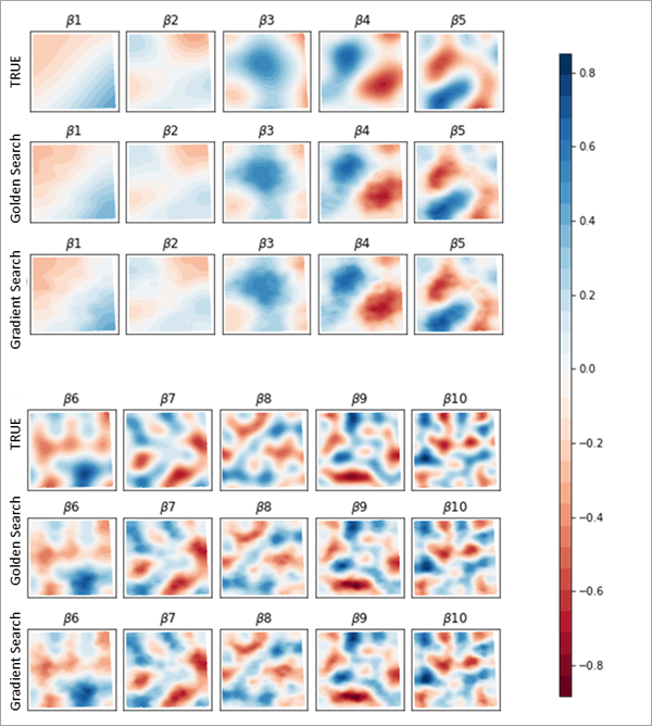

The Gradient Search neighborhood selection method option is a more recent approach to estimating optimal bandwidths in MGWR that does not use backfitting. The main benefits of Gradient Search are improved run times and efficient use of memory. This method is a second-order optimization algorithm that uses the gradient and Hessian matrix to minimize the AICc with respect to the spatial scale of the explanatory variables. Rather than updating the parameter of a single explanatory variable in each iterative step, the parameters of all explanatory variables are updated simultaneously by descending in the steepest direction of the gradient, corrected by the curvature of the AICc.
The results produced by Golden Search and Gradient Search are usually very similar. The following image shows the true coefficient surface along with the estimated coefficient surface from Golden Search and Gradient Search. Notice that all surfaces are similar and estimate the true surface accurately.
Coefficient surfaces of Gradient Search and Golden Search

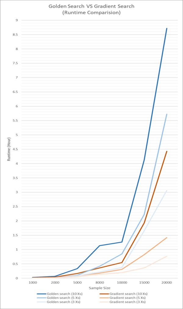

The image below compares the run times for Golden Search and Gradient Search for different numbers of explanatory variables and different dataset sizes. The run time of Gradient Search is consistently approximately half of the run time of Golden Search for the same number of explanatory variables.
Run time comparison of Gradient Search and Golden Search

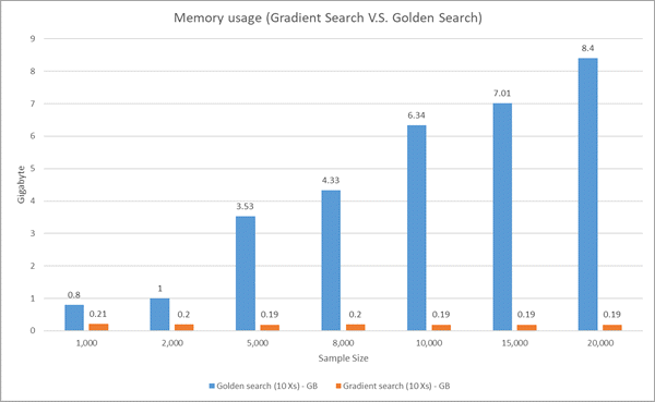

The image below compares the memory usage of Golden Search and Gradient Search. The memory usage of Golden Search increases rapidly (quadratic growth) as the sample size increases, but the memory usage of Gradient Search is unaffected by the sample size.
Memory comparison of Gradient Search and Golden Search

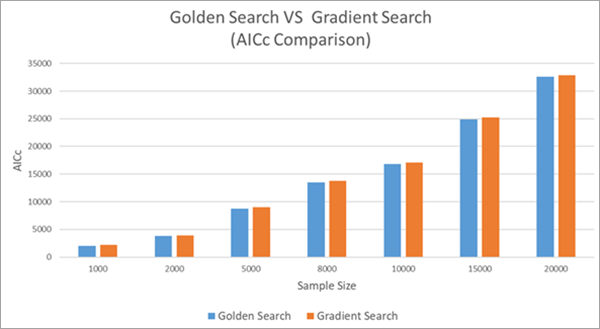

The image below compares the AICc values of Golden Search and Gradient Search. The accuracy of the methods is very similar, but Golden Search achieves slightly lower AICc values (indicating a slightly more accurate estimate) than Gradient Search.
AICc comparison of Gradient Search and Golden Search
