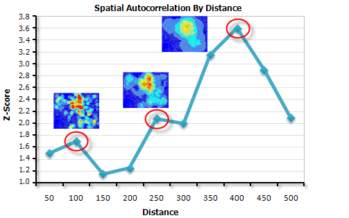

Illustration
Incremental Spatial Autocorrelation tool illustration
Z-score peaks reflect distances where the spatial processes promoting clustering are most pronounced.

  • The optional Output Table parameter value will contain the distance value at each iteration, the Moran's I Index value, the expected Moran's I index value, the variance, the z-score, and the p-value. A peak would be an increase in the z-score value followed by a decrease in the z-score value. For example, if the tool finds z-scores for 50, 100, and 150 meter distances, 2.95, 3.68, 3.12, the peak would be 100 meters. The output table also includes a Spatial Autocorrelation by Distance line chart that displays the z-score for each distance that you can use to identify the peaks.
