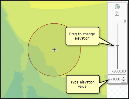

You can change the elevation of the preview surface by either dragging the elevation slider on the right of the preview surface or typing a value beneath the slider. This allows you to interactively view horizontal transects at different elevations. This experience is analogous to using the range slider to change the elevation of the geostatistical layer in a map outside of the wizard. You can also change the elevation by typing a value into the Z coordinate on bottom-right section of the preview page.
Elevation slider in Geostatistical Wizard
The Elevation inflation factor will optimize itself by default. If you change any other parameters, such as the semivariogram model or the subset size, you can calculate a new optimal elevation inflation factor using the Optimize button .
