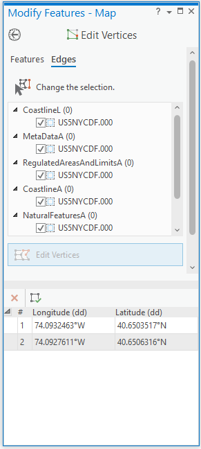

Edit a topological vertex
The Edit Vertices tool can edit topological vertices and preserve the connectedness of shared boundaries if Map Topology is turned on. You can move, delete, or add topological vertices. This tool is available in the Modify Features pane.
To edit a topological vertex, complete the following steps:
Remarque :
If you already enabled map topology, proceed to step 2.
  1. On the ribbon Edit tab, in the Manage Edits group, click the Map Topology drop-down arrow and choose Map Topology .
    Map Topology
    Conseil :
    To isolate topological editing to layers participating in a geodatabase topology rule in the active map, choose the Geodatabase Topology rule that appears in the Map Topology drop-down list.
  2. In the Manage Edits group, in the Features group, click Modify Features .
    The Modify Features pane appears.
    Edit Vertices tool in the Modify Features pane
  3. Click the Edit Vertices tool .
    To find the tool, expand Reshape, or type Vertices in the Search text box.
  4. Click the Edges tab.
    Conseil :
    To selectively highlight topological edges and nodes by hovering, set the display style to Select Elements. To learn more, see Configure map topology options.
    The topology graph highlights in the map.
  5. To move or delete a vertex, click Select edge or node , and click the vertex you want to edit.
    The selection appears in the Edit Vertices pane.
    Selections in the Edit Vertices tool pane
    The editing toolbar appears on the map.
    Editing toolbar
  6. To move a vertex, click and drag it using the pointer or right-click and use one of the following commands:
    Move Move
    Move the vertex by a specified X and Y distance.
    Move To Move To
    Move the vertex to the specified coordinate location.
  7. To add a vertex, click a segment, right-click it, and click Add Vertex .
  8. To delete a vertex, right-click it and click Delete Vertex .
  9. Click Finish or press the F2 key to apply your changes.

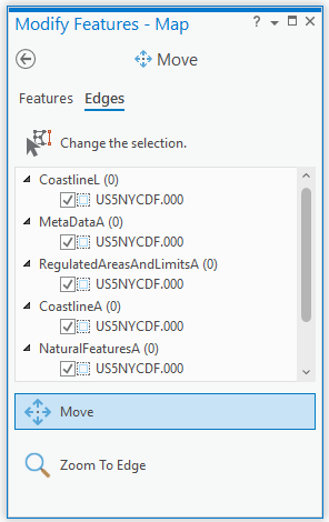

Move a topological edge or feature
The Move tool can select and move a topological feature or a topological edge if Map Topology is turned on. This tool is available in the Modify Features pane.
To access the Move tool, complete the following steps:
    Map Topology
    Conseil :
  3. Click the Move tool .
    To find the tool, expand Alignment, or type Move in the Search text box.
Complete the steps in the following sections to move a topological edge or feature, or a topology node.
Use the Edges tab to select and move a topological edge and preserve its direction and length. Topologically connected edges stretch and remain connected.
To move a topological edge, complete the following steps:
  1. Click the Edges tab.
    Conseil :
    To display the topology graph only when hovering over a feature, set the display style to Select Elements. To learn more, see Configure map topology options.
    The topology graph displays in the map.
  2. Click Select edge or node and click the edge you want to edit.
    Move tool for edges
  3. In the selection view, review the check boxes for the selected edges and their origin layers.
    • To temporarily disable editing for a layer or an edge and keep them in the selection set, uncheck the corresponding check box.
    • To turn a selection on or off, click the select box. Alternatively, right-click a selected item and click Unselect or Only Select This .
    Conseil :
    To split a connection between one or more topological edges, disable editing for the feature or turn off the selection.
    The Edges tab
  4. Hover near the edge you are editing and drag the edge when the pointer changes to the move or segment cursor.
    To move the selection anchor, press Ctrl, hover over the anchor and drag it when the pointer changes to the directional cursor .
    Conseil :
    To preserve the general shape of the connected edges, turn on Stretch Topology on the editing toolbar.
    The selected edge updates and topologically connected edges stretch and remain connected.
  5. To apply your changes, click Finish or press F2.

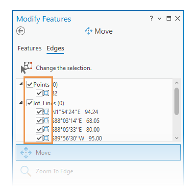

Move a topology node
The Move tool and Edit Vertices tool can select and move topological nodes when topological editing is turned on. These tools are available in the Modify Features pane.
To move a topology node, complete the following steps:
    Conseil :
  2. Click Select edge or node , press N on your keyboard, and drag a selection across the nodes you want to edit.
    Move tool for nodes
    Conseil :
    The Edges tab
  4. Drag the topological node.
    The selected node updates and topologically connected edges stretch and remain connected.
  5. Click Finish or press F2 to apply your changes.
Remarque :
If the new location violates a topological relationship, the edit operation fails to build polygons from the current topology elements and the Modify Edge error dialog box appears.
Modify Edge dialog box
Click OK to close the dialog box and cancel the edit.

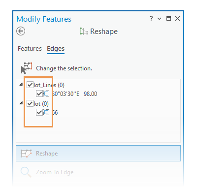

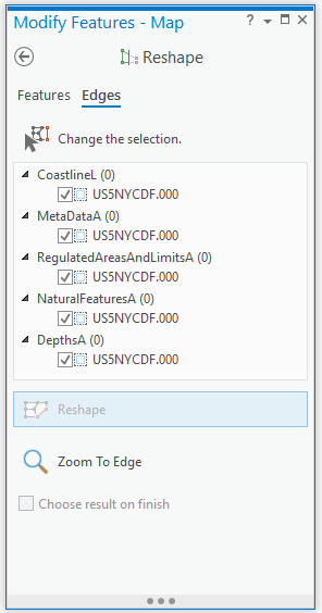

Reshape a topology edge
The Reshape tool reshapes selected topological edges for features on editable layers when topological editing is turned on. This tool is available in the Modify Features pane.
To reshape a topological edge, complete the following steps:
Remarque :
    Map Topology
    Conseil :
  3. Click the Reshape tool .
    To find the tool, expand Reshape, or type Reshape in the Search text box.
    Conseil :
  5. Click Select one or more edges and click the edge you want to reshape.
    The selected edges appear in the selection view organized by layer and the pointer changes to the draw cursor.
    Reshape edge tool
    The selection appears in the pane and is highlighted in the map. The editing toolbar appears with construction tools.
  6. In the selection view, review the check boxes for the selected edges and their origin layers.
    Reshape
  7. Draw the new shape across the existing edge.
    The new shape must cross or touch the topological edge in two or more places.
  8. Click Finish or press F2 to apply your changes.
    Remarque :
    If the new shape violates a topological relationship, the Reshape failed notification appears in the pane and the edits are canceled.
    Shared topological edges update and remain contiguous.
Remarque :
