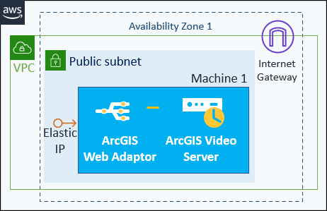

This template can create the following architecture in Amazon Web Services:
ArcGIS Video Server site on one EC2 instance with optional Elastic IP and web adaptor
