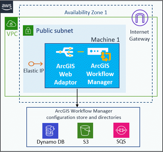

The following is an example of an architecture you can create on AWS using this template:
ArcGIS Workflow Manager site on one EC2 instance with the configuration store and shared directories in cloud storage and optional Elastic IP and web adaptor
